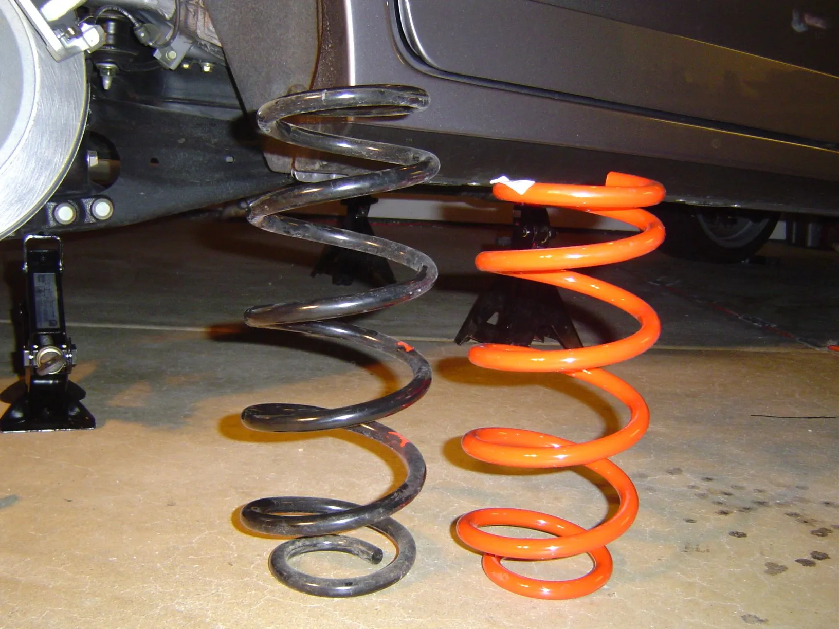

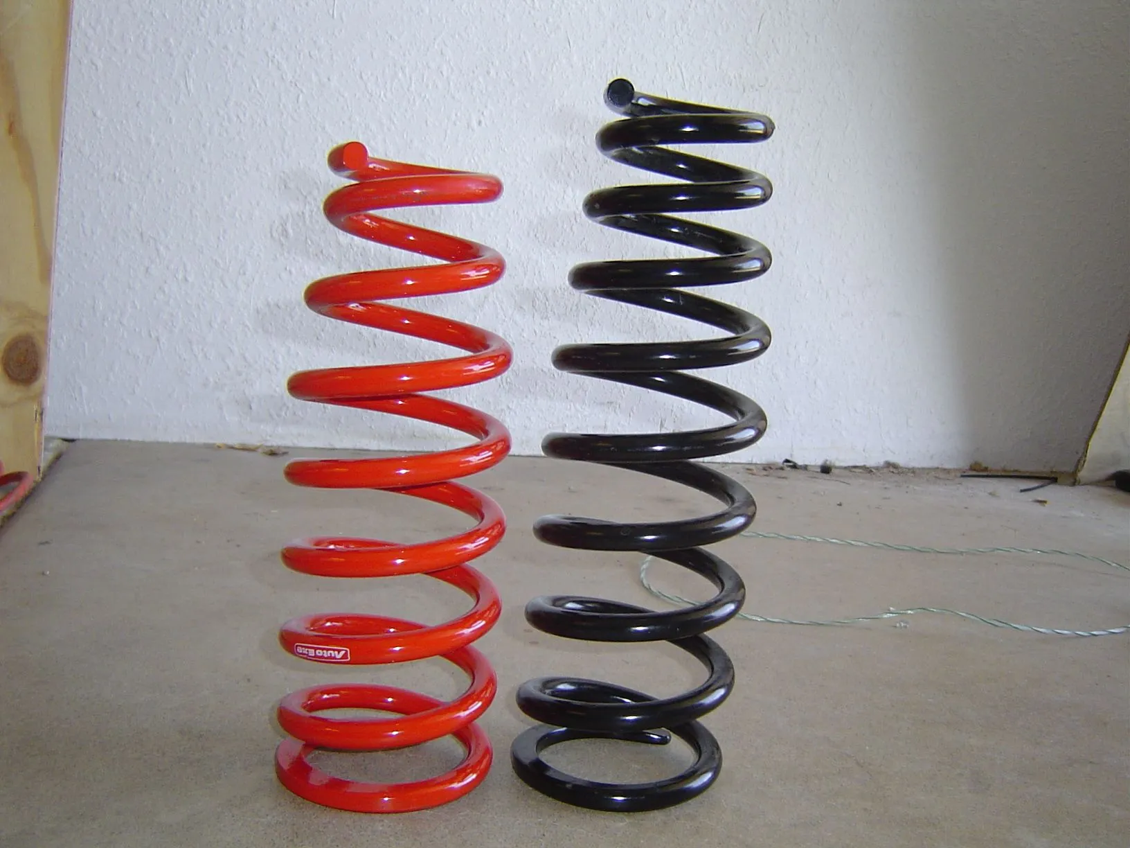

So I got them Wednesday and put them on today. I have a little over an inch drop right now and it looks pretty good. I rub like crazy with the 235's on it, so it's time to roll the fenders. I took some pics of the autoEXE's next to the stockers, I'll post them up later tonight.
The ride doesn't really feel any different then before, which is nice. Overall I like them so far and will like them better when I quit cutting into my tire.

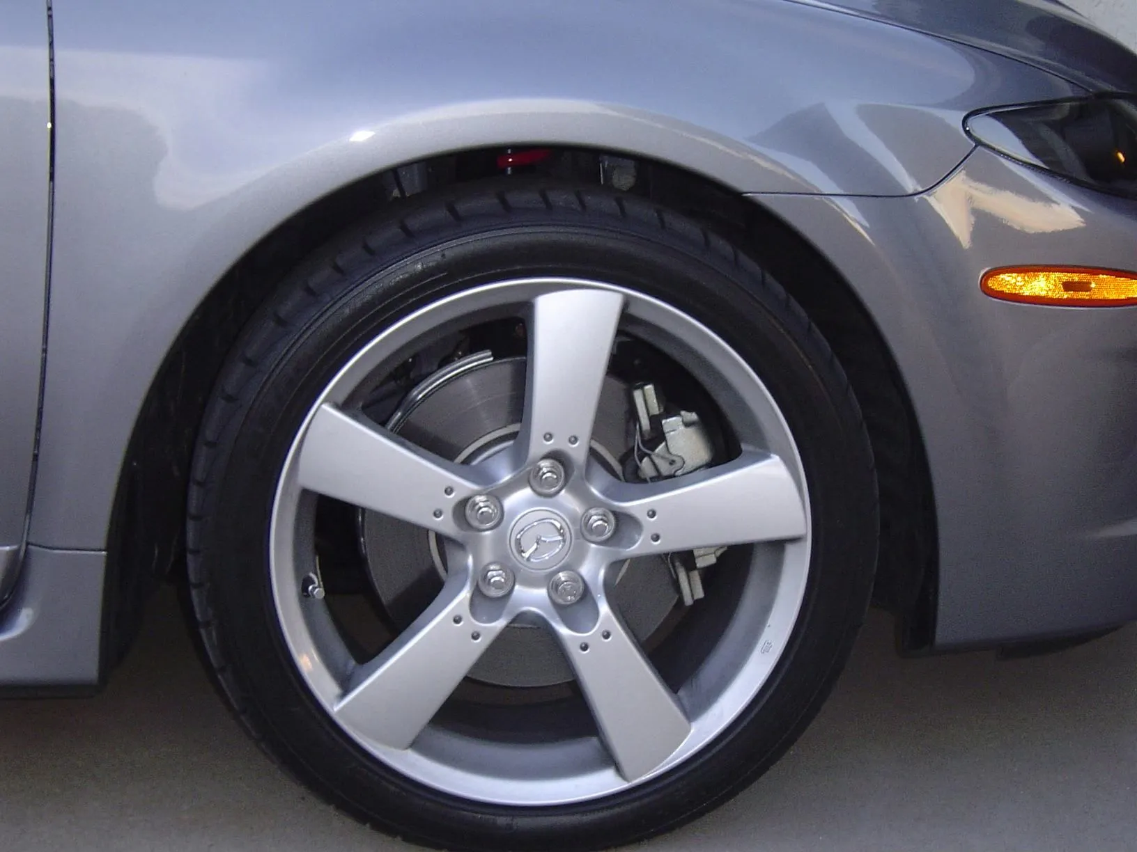

Wiggum---how are yours not rubbing if my setup matches yours? I have the 235's on RX-8 wheels.

What size are the RX-8 rims? Also did you get the Low Down Autoexe or the regular springs.

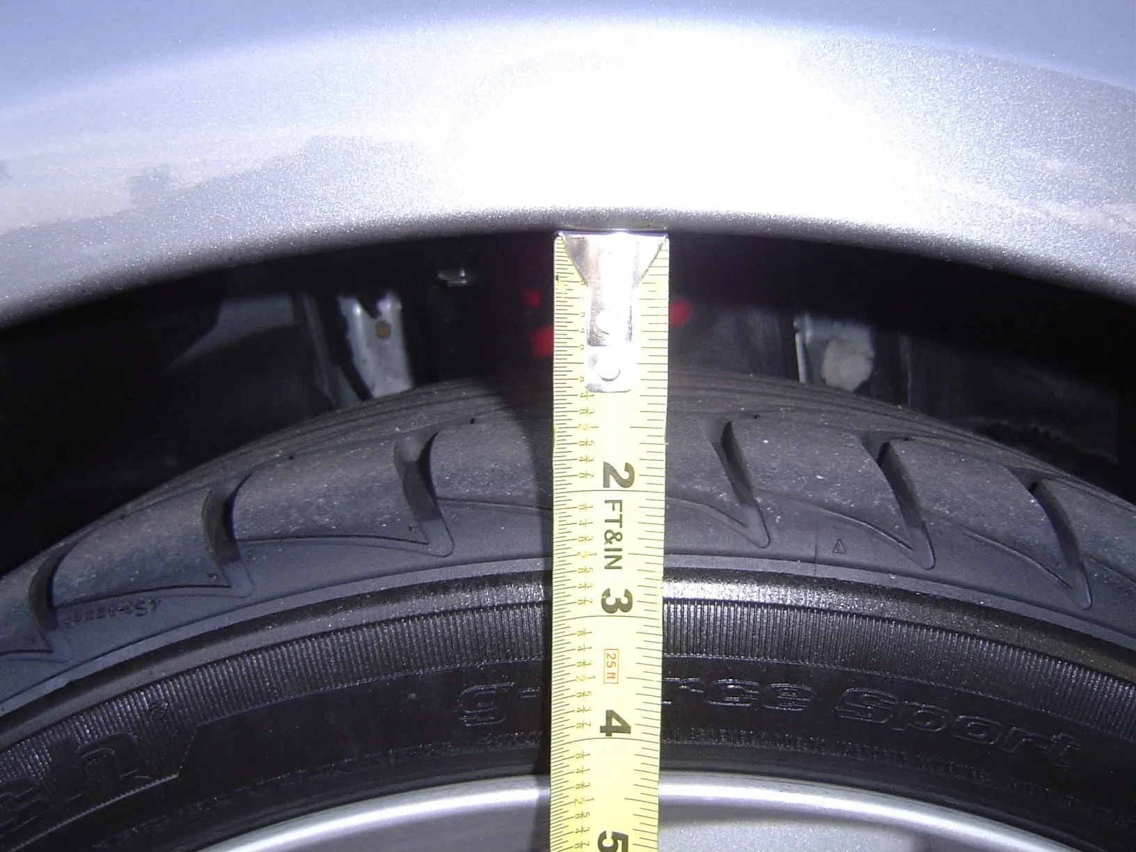

The rims are 18x8 with a 50mm offset and yes they are the low down springs. They have settle nicely and I have about a one to one and a half inches of whel well now. With the fenders rolled, I don't rub anymore.

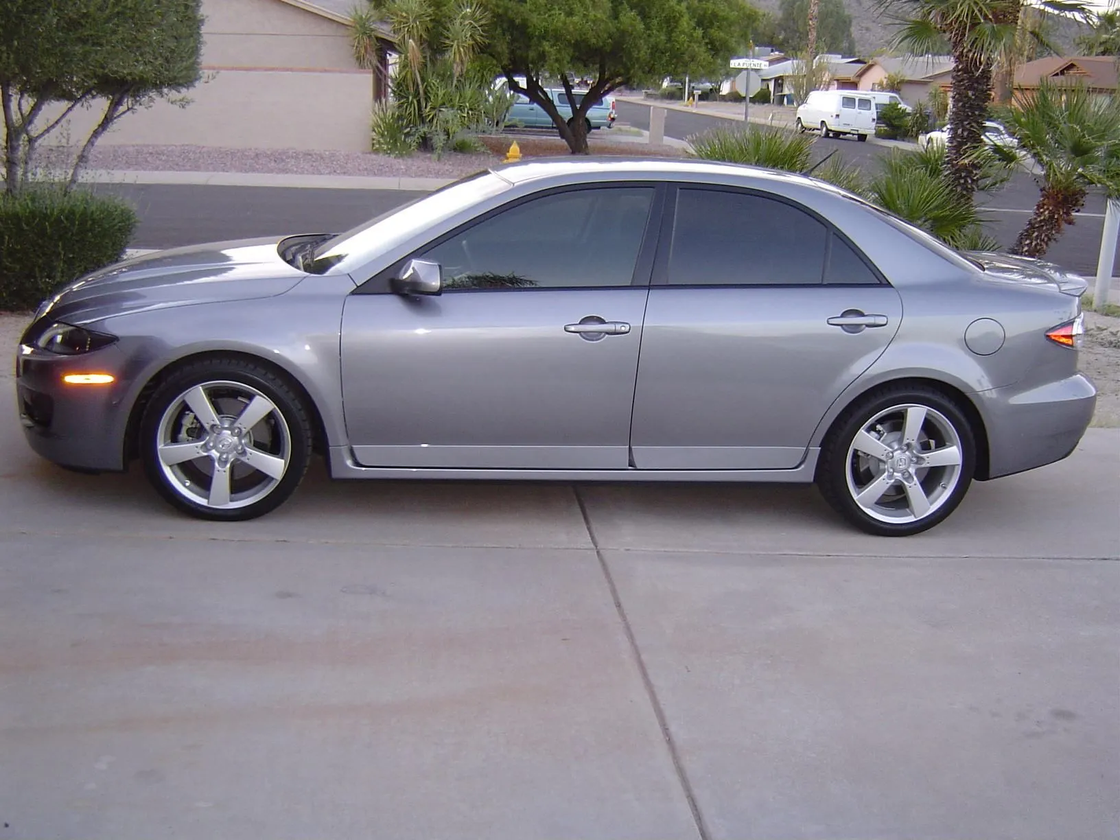

OK, I got off my butt and took some pics.
i was thinkin the same springs here... hows the ride differ? noticable in corners, bumpy, etc...? but it looks good man liking the rx8 wheels thats what im doin today shop for wheels getting painted tuesday
Dunno if they are progressive or linear, Wiggum would know. As for the ride, I can hardly tell any difference. It still takes the bumps real nice, just a little more feel then stock, but for the most part, I cannot even tell it is lowered.

AutoEXE are linear.
OEM spring rates are 280 front and 185 rears.
AutoExe springs rate are 370 linear and 225 linear.
That is a front increase of 32%... a rear increase of 22%...
AutoEXE is lowered 30mm. Approx 1 1/4".
