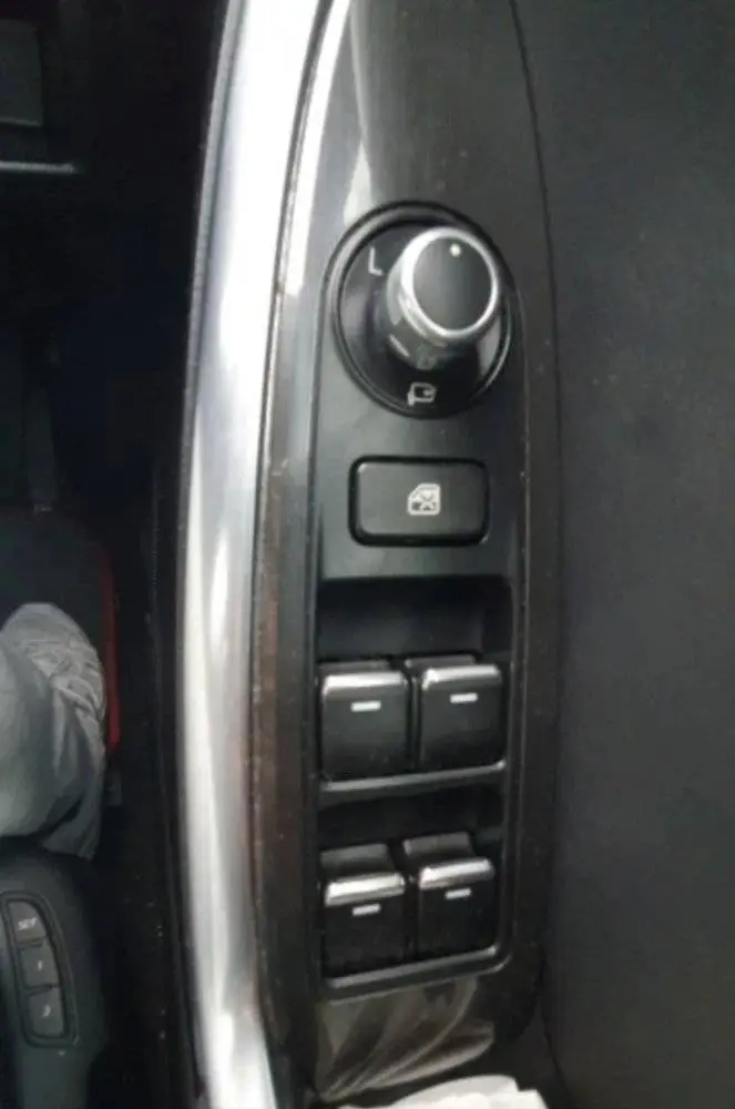

Hi everyone! I own a 2016 Cx-5 right hand drive and need your advice to install the auto folding mirror kit. Unfortunately, the link posted by Kirn is not working anymore but the idea of installing a device that requires only 3 wires to be spliced is very appealing. Before finding this thread I bought the following device which is universal. Could any of you recommend something compatible with my car, ideally plug and play or with as less wiring slicing as possible?

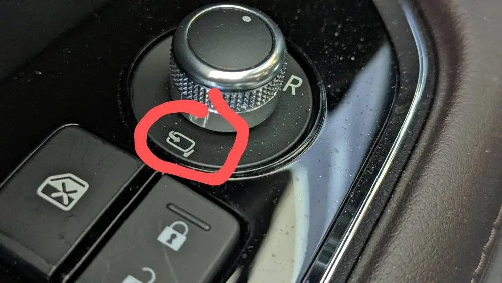

In the US, we don't have power folding mirrors.
We don't? Don't tell that to my mirrors that fold when I lock the car and open when I unlock it. - or to my manual power fold option. - unless I mis read the post.
