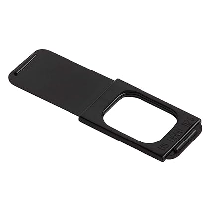

It won*t dim in the daylight, that is the achilles heel with the damn things and when you get white van man right up your rear end, you have to put up with his confounded headlights. There is only one work around and that is a bit of tape over that light sensor on the windshield side. It will be permanently dark, even in the daylight but you can adjust the tape to let a tiny bit of light through and have it semi-dimmed. If you*re really inventive, you*ll make a slide over door.
Instead of making one, and if that enabling the dimmer in the daylight is the resolution to your problem, I'd suggest sticking a webcam cover over the front light sensor to enable / disable in daylight. Just don't forget about it at night time.

That would be perfect.
