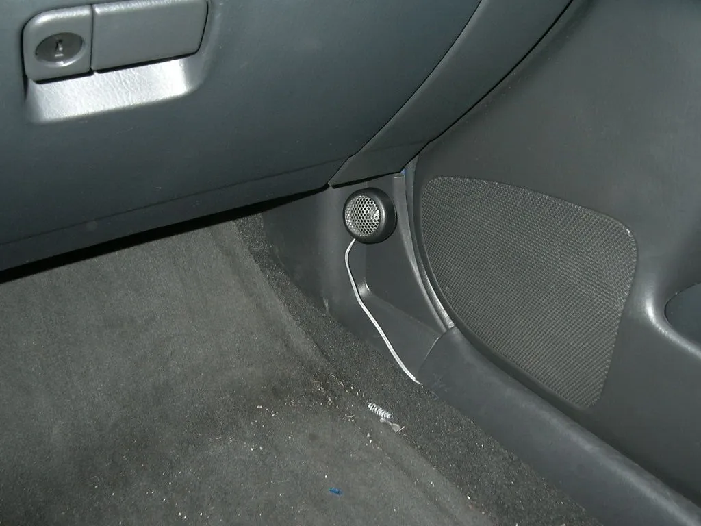

At anyrate, a couple places where chuyler and I differ isthat I prefer tweeters mounted lower, and larger subwoofers. If you don't mind sacrificing a bit of space, a 12" sub gives you essentially more output capability and lower overall responce for roughly the same $ as an 8 or 10. It mostly depends on your particular listening tastes, but you can always back it off, can't always add more without making an investment in new gear.
As for tweeters I've attached the only pic I have of my car with a 2-way component setup. It's sloppy as it was while I was still trying things out, but position-wise This was my finalized tweeter placement after alot of playing with things and trying locations everywhere from rearview mirror to on-axis including stock locations, etc. I even did a silly experiment with a couplefew LED lights placed around my car in different places driving around with my friends at nightwithout telling them why. Basically this place 90% of the time with varied friends of differing sizes/clothingstyles, etc remained primarily unobstructed. I also find it as no coincidence that many others in here have independantly settled upon the same place for tweeter mounting. Recently Basementgeek posted about it and he stated his were there same as RyanJayG's. Of course this is all subjective and if you've got the time and patience, the best way is to get some good 2-sided tape and try for yourself after you've got your speakers.
