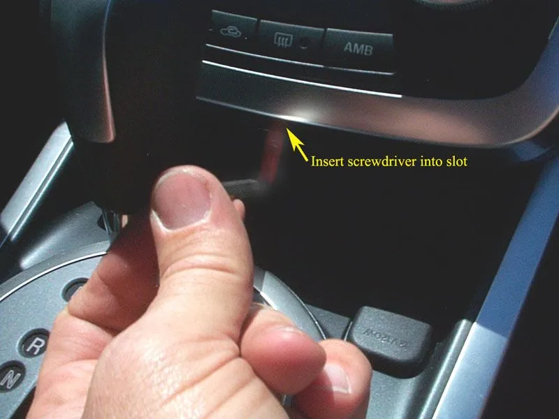

I was a bit hesitant of removing the center bezel, but was assured by a few forum members that it wasnt to difficult. I went and bought a pack of plastic putty knives to slip through the cracks of the bezel and release the clips, but found out a trusty 2 bend screwdriver was all that i needed to do the job.
I'll just post some pics of the very simple removal, and show the position of the enormous amount of clips and there location for others doing this job.
Below is the screwdriver, with a bit of electrical tape around it:

Put the screwdriver in the tiny slot at the bottom of the bezel, and gently pull straight out toward the shifter. Mine popped all 3 lower clips right out with no problems.

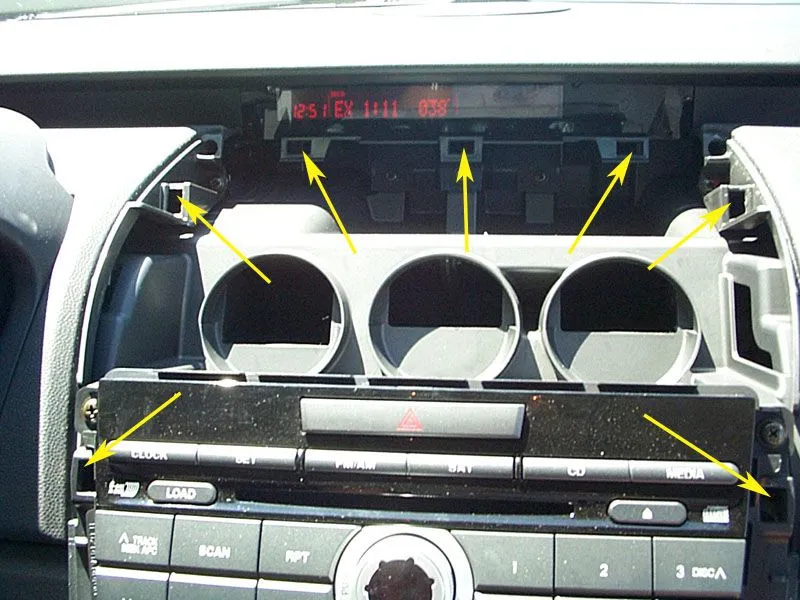

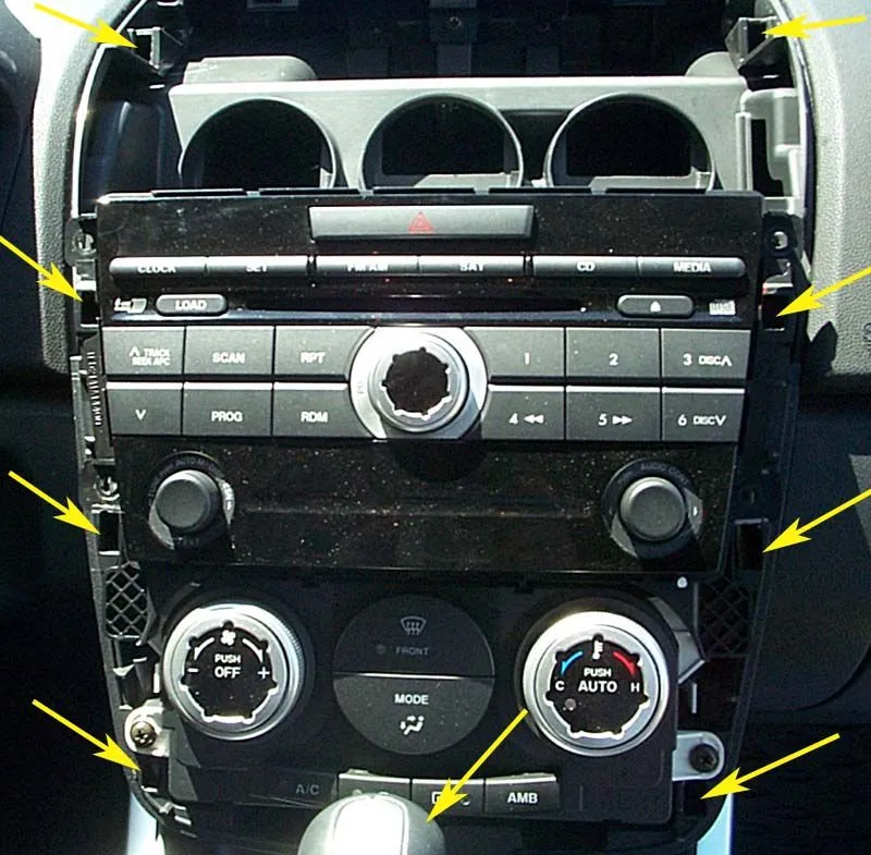

After the 3 lower clips popped, i just firmly pulled out on both sides and followed through all the way up until the entire bezel came off.
Here is a pic of the large amount of clips holding it on!!

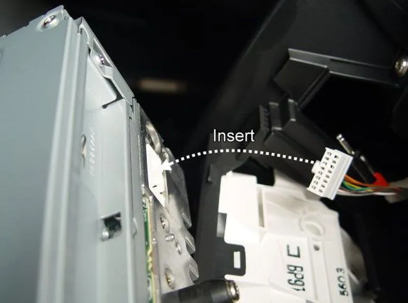

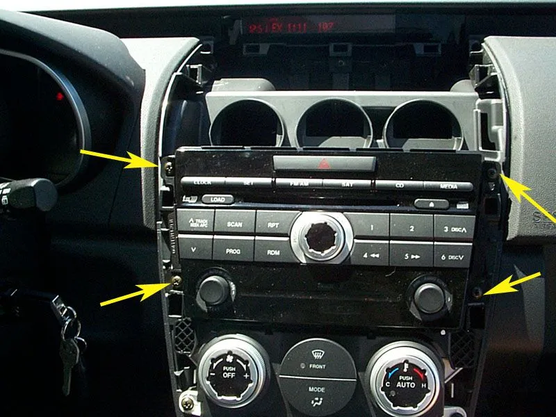

When the bezels off, it's just 4 phillips heads holding in the head unit, then pull it out and insert the Audiolink cable directly into the back of the unit.

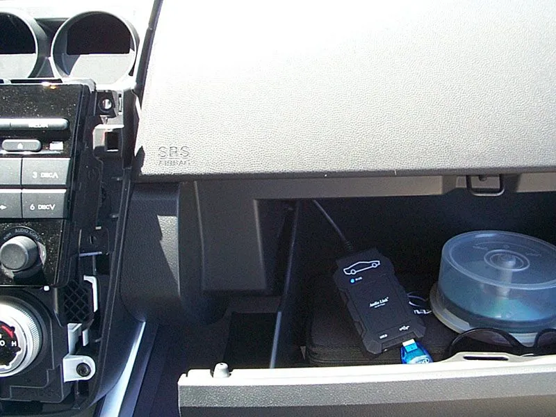

I just ran my audiolink directly to the glove box since it really isnt needed sitting out in the open. Just toss in a jump drive, or any card with a USB reader, or even headphone/line in and close the glove box and go (cool)
Here are the pictures of the holes the clips go into when the bezel is removed.
Hope this helps anyone worried about tearing into there new car!!
Took about 20 minutes for the entire job.

So I insert the Audiolink directly into the backup of the unit.
Got no signal on the device. Also the button to select cd or cdc didn't work. (pissed)

Question: I can't tell from your pictures, but would it have been feasible to put a hole in the bottom of the radio-area so that the device could sit in the "tray" in front of the shifter? (I'd probably use mine to connect my iRiver Clix through the audio jack, and would want them sitting closer than in the glove compartment.)
Also, how does the "box" connect to the cable that runs to the back of the head unit -- is it permanently attached, or does it plug & unplug?
Finally, how does it sound?
Thanks for going to the effort to help the rest of us out!

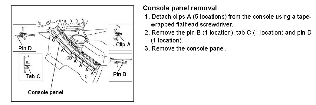

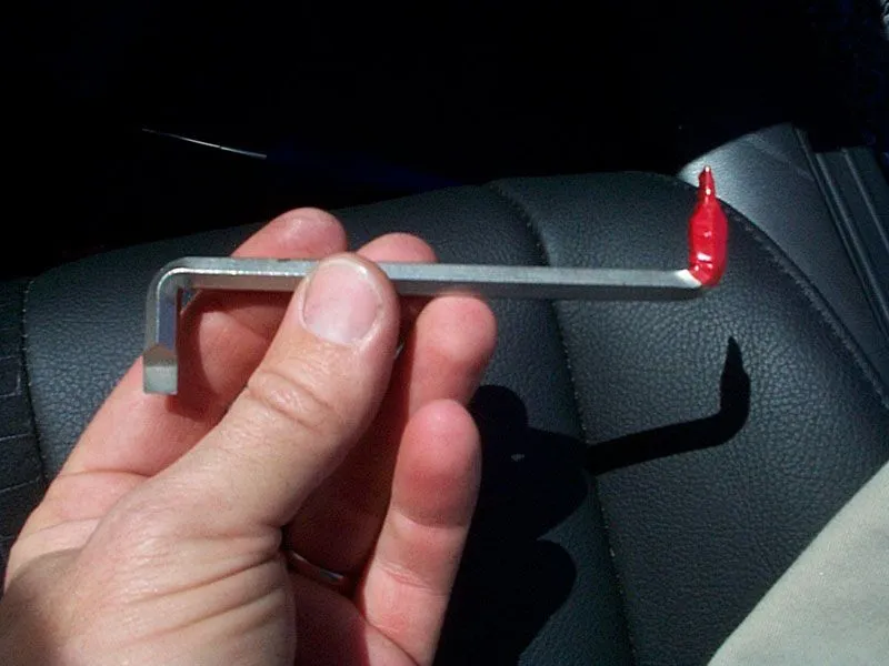

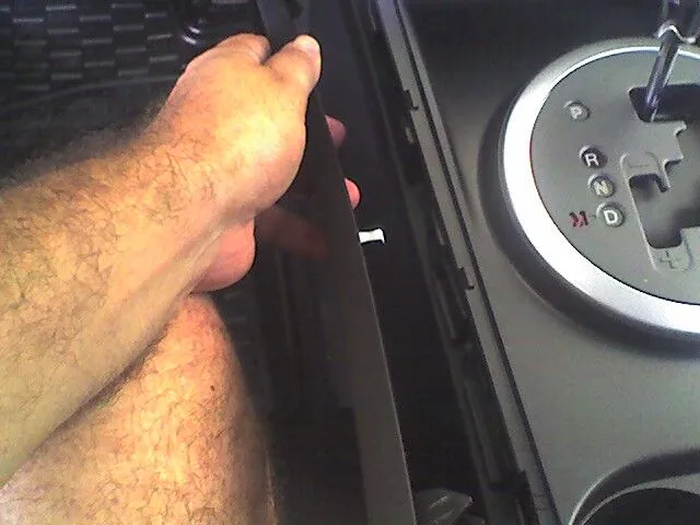

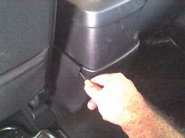

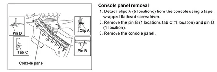

Thanks to this post by skeppley I decided to buy and install the Audiolink myself. I did about the same as cricket1977 did, running the connector underneath the center console. This post would like to complement with pictures and diagrams the original skeppley post.
I would recommend this video, that certainly gave me confidence:
http://www.howdudothat.com/view/13/audiolink-ipod-mp3-adapter-installation-for-mazda-6/
First, I disconnected the negative battery cable because I kept reading about it, so I did.
Then, I dismounted the lateral panels of the center console, as the diagrams and photos show.
