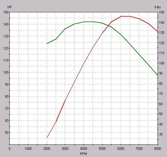

ATTN akhilleus
Here's what I get for your mods. Check for a PM explaining what I did.
With your torque peak at around 4500 you could make some really nice gains with other mods, like exhaust headers, intake/head porting, and maybe some exhaust cams.
I don't know about emissions, but when you shift the torque peak, you should try to match the airflow through the engine to get max power. You might need to increase your fuel flow for any more mods.
Thats what i figured actually.. although power seems to drop off a little sooner or at least plateau after 5.5k+ in reality.. nice torque though

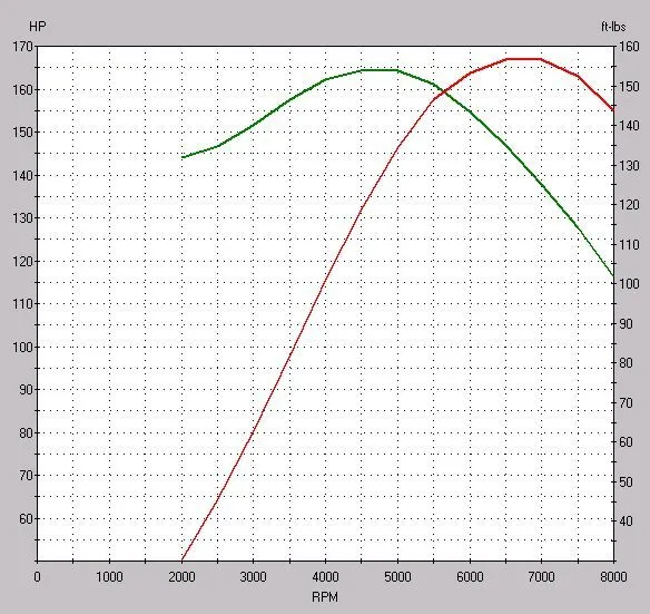

ATTN akhilleus
Here's with the exhaust cam. The problem is that I don't know the valve overlap, so I did the best I could to figure out what the power should be with 0 overlap or at 2 overlap. You need to consider that error when you look at the graph.
so power goes up but torque goes down... although in comparison it seems that i wouldnt gain much in perf.... and it seems like this graph isnt much different from twilights
I don't like the exhaust cam numbers, mainly because I can't time the cams right. I'm sure that if the cams were timed right in the program that you would see better numbers. I just don't know where to start and I can't figure out what the best timing is.
That graph is with no overlap, so basically the intake cam opens at TDC, and the exhaust cam closes at TDC. All the duration additions did was start the exhaust cam 10 degrees earlier, and keep the intake cam open 10 degrees later.
If anyone has a better idea of when the cams actually open and close the valves, I can run better numbers. Does the intake open before, after, or at TDC?
Actually, your torque went UP. The scale is on the right for torque, and left for horsepower. It looks lower but it's about 3 ft*lbs higher if you look to the scale on the right.

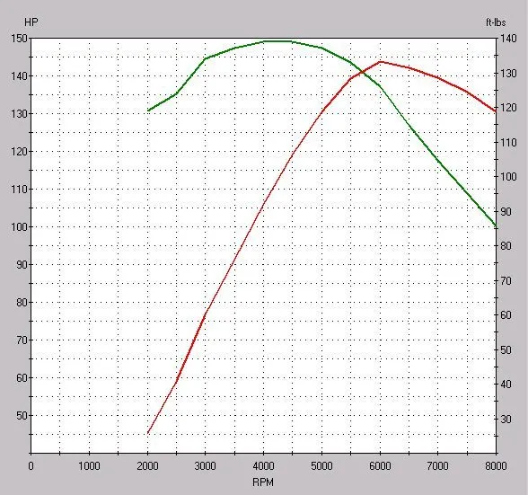

Here's that same graph, this time with exhaust headers...
