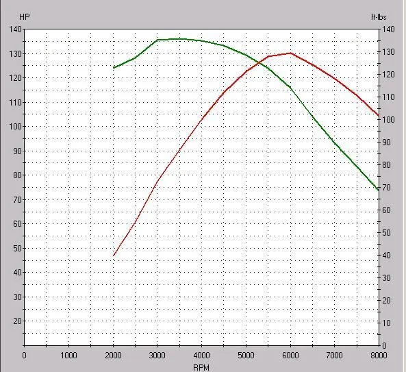

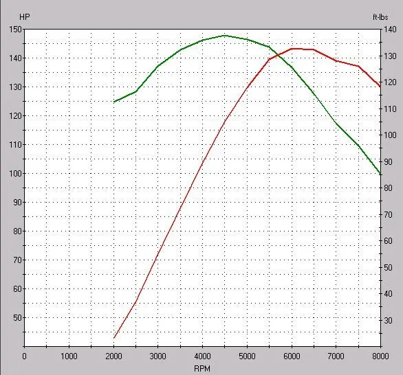

Here are the dyno charts the computer gets with stock setup (as close as i can get), and what's published about twilights setup. T- I dont' think I have your exact specs. PM or email and I'll get you a more accurate dyno estimate.
You'll notice that peak hp is still at 6000 rpm, but about 143hp. That falls only to 142 at redline (6500 rpm).

  • W:Cams.webp

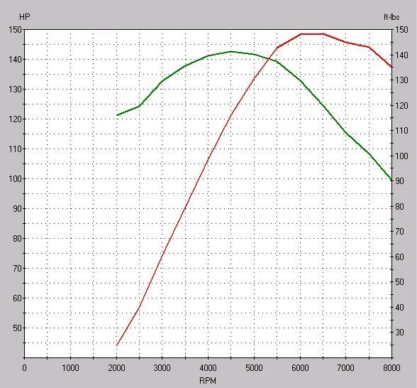

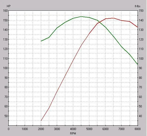

Twilight- can't PM images. Here are the dynos you requested. PM me an email address if you don't want these public.
Hehe, don't know about whether he wants'em public, but I wish the second one was mine! What were the #s on that one? PM me twilight, if you don't mind telling.
