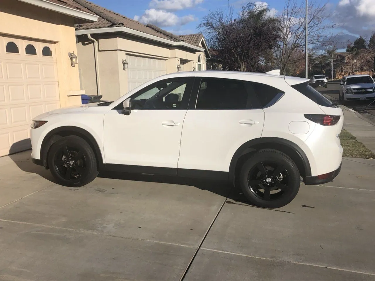

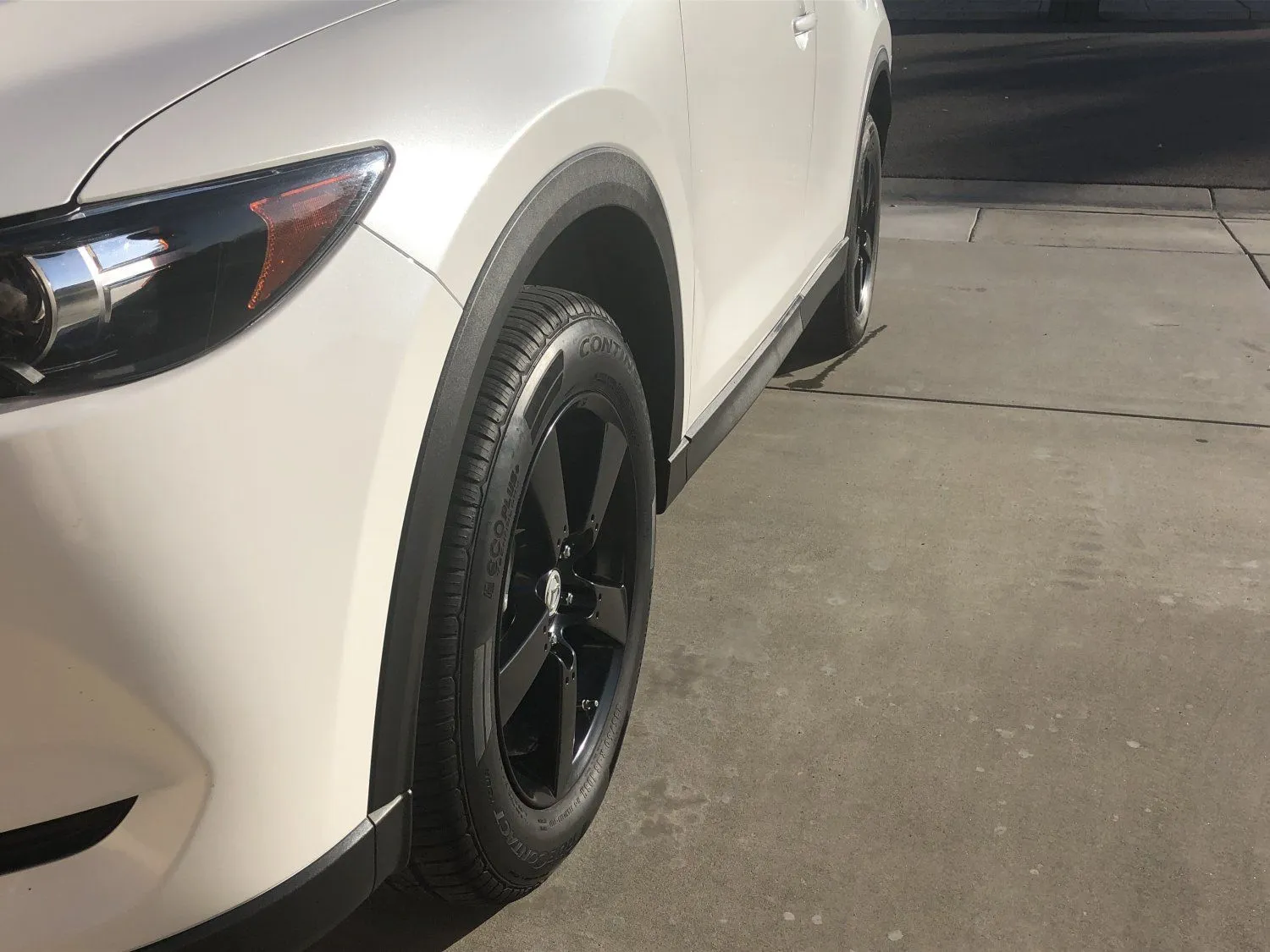

You’ll be fine with that size tire with lower offset wheel. Need to find a pic, but we’ve got powder coated rx8 wheels on our ‘19 at only 21 lbs per wheel. Benefit to these wheels is they are the same centerbore (so no centering rings) and can use stock lug nuts. 50mm offset would necessitate spacers for tires much wider than 235mm

I had them powder coated and yes they’re super easy to clean. Running 235/60/18 tires that barely clear the front struts, but no spacers, rings, etc. They bolt right up with stock lugs as if they came factory
