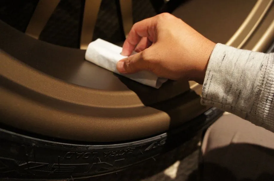

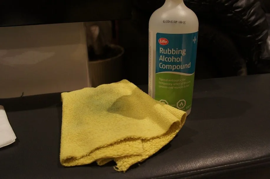

1. Wipe down the wheel with the soapy water mixture to get any grime or caked on dirt off, then wipe it dry.
2. Give the wheel a final wipedown with the isopropyl alcohol. This step gets rid of hand oils and fingerprints and ensures that the surface is nice and clean.

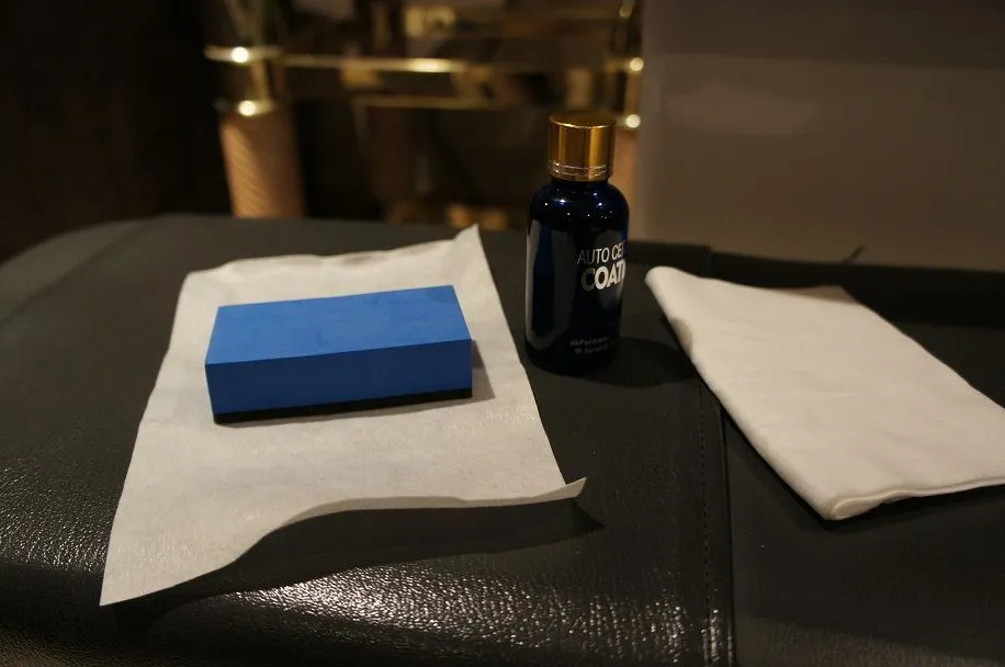

Try to keep the bottle sealed at all times. If left uncovered for long periods of time, the coating may crystallize inside the bottle. When applying the coating, you don't need much. A few drops at a time worked well for me. It also helps if you have a wedge block or soft sponge of some kind to wrap the applicator cloths with. Because I only had the block, I wasn't able to get into the tighter areas of the wheel hub, where the spokes meet.

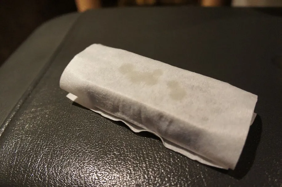

1. Wrap a clean applicator cloth around the applicator block, then carefully apply 4-5 drops of the ceramic coating.
attachment.php

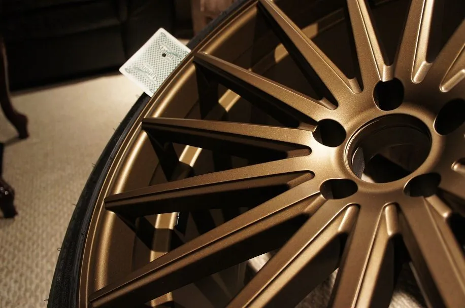

6. Again, work in small sections. I did 3 or 4 spokes at a time, making sure I coated as much of the surface as I could reach with the applicator (the playing cards are just there as markers). Toss out the used applicator cloth when you're done.
attachment.php

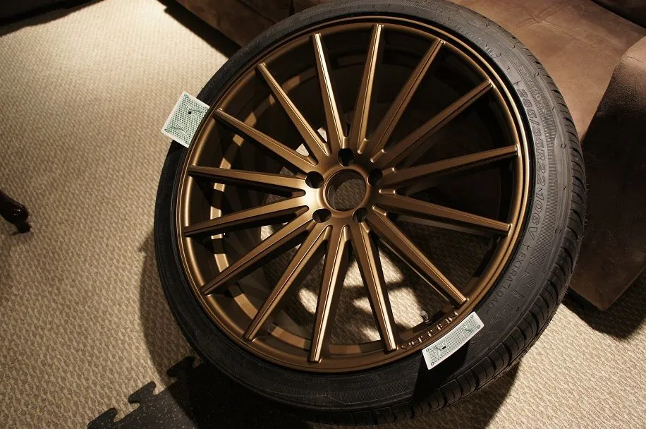

7. Give the face a final wipedown with the buffing cloth, making sure there is no streaking or hazing - these are "high" spots, and they are left to cure this way, the wheel will always look streaky until the coating wears off or until you strip it by polishing it off. Carefully move the wheel and set it aside to cure.
attachment.php
The wheel should cure in a day or two (faster if it is in the sunlight). If you were to touch the wheel before the coating cures, it would feel slightly tacky, but it's almost not noticeable.

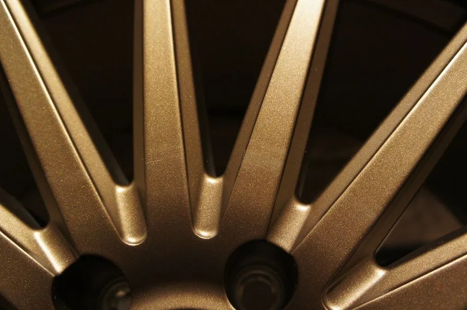

So far, I've only coated one wheel and prepped one more. I'm doing it bit by bit and taking my time with it as a cold virus makes its way through my house and family, lol. I also noticed that applying the coating helped to hide the very, very slight marring in the paint from the tire mounting shop. This is a picture from right after I had prepped the wheel:
attachment.php
The only visible imperfection after the application is the single hairline scratch running horizontally. Ceramic coatings are not designed to fill in imperfections like these, so I'm not sure what happened here, but hey, I'll take it :P
