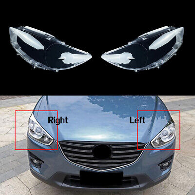

My 2014 has some yellowing and degradation along the top edges of the headlight lenses. I've thought about sanding and 2K clear coating to restore them, but honestly I think new lenses would look even better. Has anyone tried any of these replacement lenses on eBay? Unfortunately they all come from China, but there's really no other choice that I can find. Yes I know how to bake and open headlights, and I have new butyl sealant to go back in them, so that's not a problem. Anyone tried them?
I would be concerned about fit issues and overall quality of the plastic. No way of knowing till you get them unfortunately, looks like they have a 30 day return policy though. I found these 2pcs Mazda CX5 2013-2016 HeadlightsXenon if ya got cash to burn lol. They are unique but pricey.
pffft heck no, I would retrofit HID projectors for a fraction of that price before I bought those. $1,700 that's insane. Actually I think you could buy OEM Mazda HID headlight units for less than that. They're around $600 a side if I recall.
