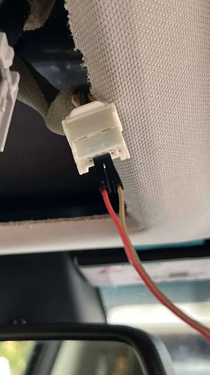

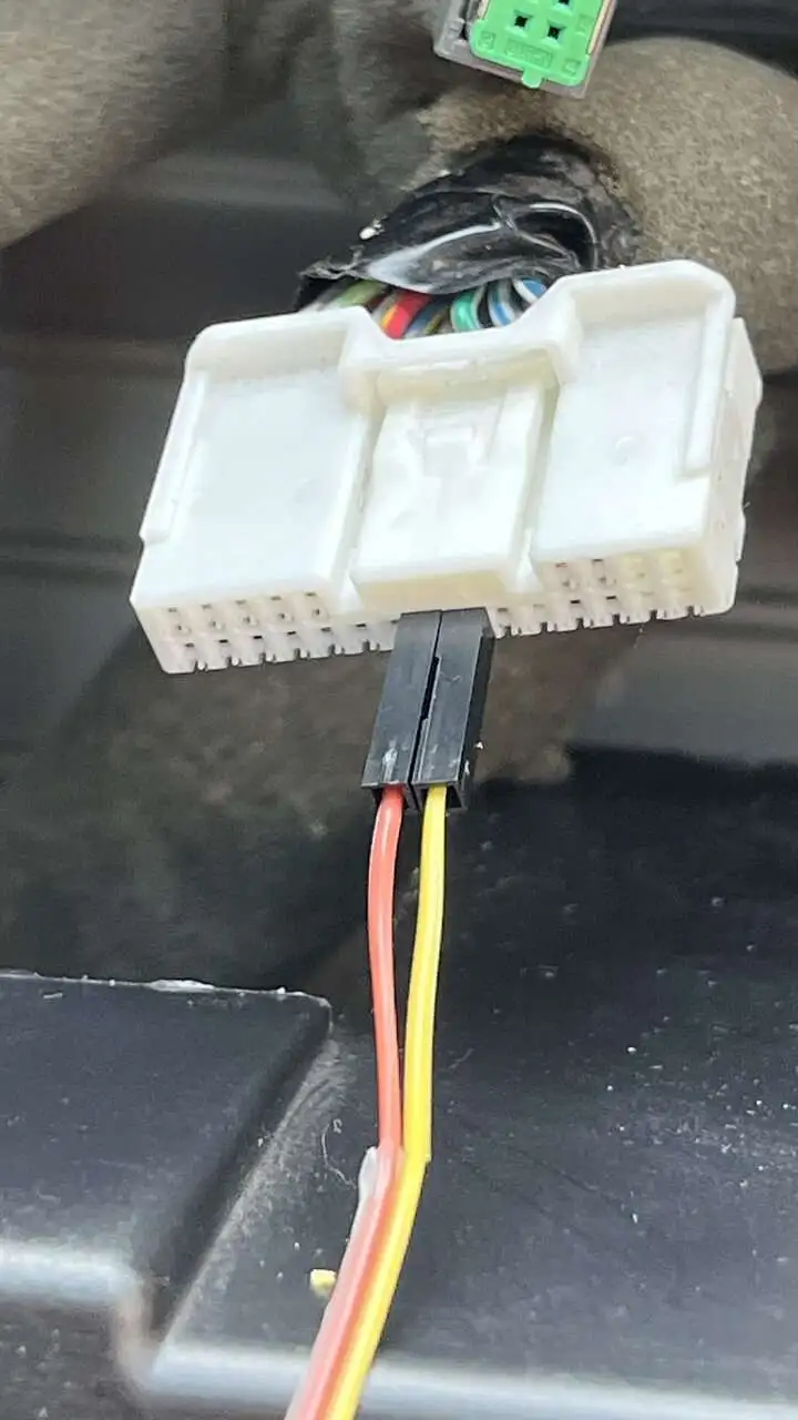

I did it just yesterday and it worked well. Just followed the instructions on that post above. I used wires with individual header connectors, then secured them with some tape to avoid them separating. The other end of the wire I soldered to the microphone black and red wires. The first picture is the connector behind the radio. The second is in the overhead compartment.
