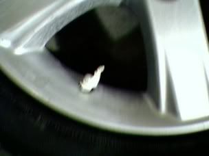

6) Now that you have the damaged areas fixed you lets get ready to paint. Put some masking tape around the air valve:

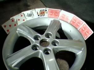

7) Now take the playing cards and place them in the edge of the tire like so, I found that this was easier than using masking tape:

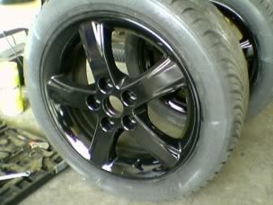

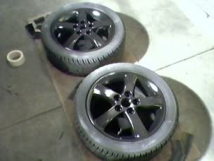

10) Now after your done with the primer I would wait an extra 30min before applying wheel paint. Now apply your wheel paint. I did about 5 coats of wheel paint, and again waiting 15-20min between coats. I chose a gloss black paint. Here they are after 5 coats of wheel paint, MMMM Sexy!
11) Now for the clear coat. I let the paint dry overnight before I aplied the clear coats. Sometimes if you have many layers of paint that are not dry enough and you apply clear coat, the clear coat will pull on the paint layers making cracks and wrinkles in the paint. WE DON'T WANT THAT! I did three layers of clear coat, two light coats followed by one heavy coat. And here they are!!! Good as new!
12) Last step. If you got any paint on your tires take a wrag and some acsitone or paint thinner and rub them clean. Now install and enjoy! I will do a photo shoot in the reserved post below once I get them back on today so check back. Good luck to all and let me know if you have any questions.

I tried the playing card route on a set of wheels from a previous car and it was kind of annoying because they wouldn't stay in place. Considering how much time I spent scraping and sanding those wheels, I think I prefer the tape because that stuff is not going anywhere. If you were just paint, and not stripping first, then playing (or index) cards would probably be fine.
i used the playing cards on mine and they worked just fine for me haha i was just to lazy to tape it all up haha
