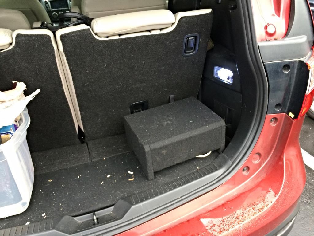

I looked at using the one from the 6 (you can find a bunch of them on ebay) but I already had a 8" shallow pioneer sub from my old car so I went with a Pioneer UD-SW200D box, its tiny and light for a speaker box (easily movable with one hand), fits with all seats up, and most people will be unable to tell its a box since its down firing (speaker not visible) and tiny.
I think as long as you are not craving the bass from dual 10" subs or greater this will more than fulfill your needs, its close to a single 10" in a sealed box, but not in a ported box with a bass track.
FYI only down side to the box, which I later found seems to be a common problem, was the speaker hole was just slightly too small, but with a dremel and 10min the sub fit just fine.

I agree its nice having things completely out of the way but those OEM spare tire subs are way too under powered for my needs; I don't need a lot of bass but I do need more than those OEM spare tire subs give out.
Its just a speaker box so it has normal speaker box spring loaded quick disconnect terminals; I also left the speaker wires pretty long so I can drop the 3rd row and move the box up to the back of the 2nd row seats without disconnecting the wires if I need to.
Doing any real hauling of any kind requires dropping the 3rd row seats, and unless you always travel with nothing in your trunk you will always have to move something. I always carry jumper cables, a first aid kit, and some tools, so moving a little box is nothing really.
How do you have the box mounted to the floor ? Brackets ? Velcro for easy removal ?
Right now its just sitting there, I might strap it down or velcro it but for now its just wedged in place by all the extra crap I have been carrying around lately.
Oh and the rear pockets I mentioned in the PM are the ones that have the scissor jack on the left and storage on the right.

Is that preamp'd or do you have an external amp mounted somewhere? If so, would like to see where.

I saw that post with the under seat sub/amp combo, but I already had my sub and amp from my previous car, the only thing I had to purchase was the box so it made more sense to go this route.
Amp is under passenger seat, also was able to get it to fit where the scissor jack is but my amp power wire was too short.
My amp has high level inputs but since i have a aftermarket deck I just used its preouts.
If you only want a little bit of bump try 4 new speakers and find a way to enclose the two rear speakers, from the factory they are just bolted to a metal panel with no backing, maybe try one of those baffle foam enclosures, and if you need more pick up something like the Clarion XC1410.
