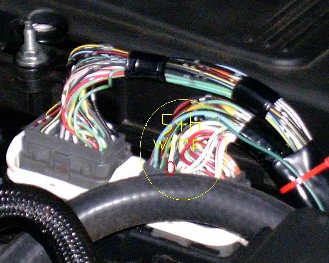

Look at the ECU document here. It shows all the connectors on the ECU (that's what's in your picture). If you tap into the wideband, your gauge won't work, and your car won't either because you will screw up the ECUs ability to sense the A/F ratio. You must tap into the narrow band sensor, but don't expect a lot because that sensor is after the CAT, and narrow band is pretty useless anyway.

Ive been asking about this and this is where someone told me to tap..
I looked at the same that was UHATEIT that took that off another forum. Have you tried it yet?
that would be me. I used that one and it worked from the first time. Thats for those basic a/f guages the narrowband ones but the wideband ones you do have to drill out a bung for it. or if you have a testpipe that has the bung built in (i have the protegegarage tp and it has one) then you just have to get the sensor for it.
I didnt run mine to wideband, i just tapped that wire for narrowband on the ecu harness next to the battery and it worked like a charm![]()
Yes It did.. The A/F is working JUST FINE.. Thanks UHATEIT. (bow)
