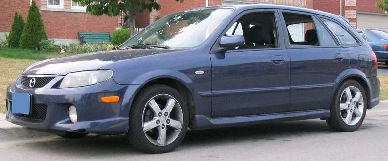

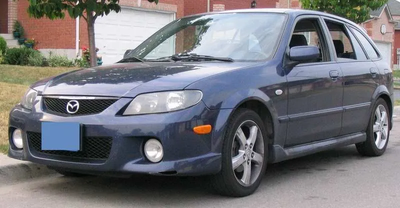

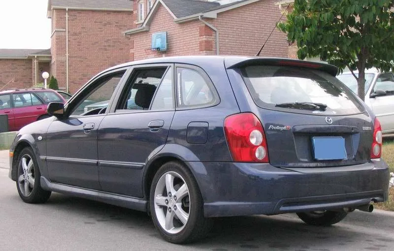

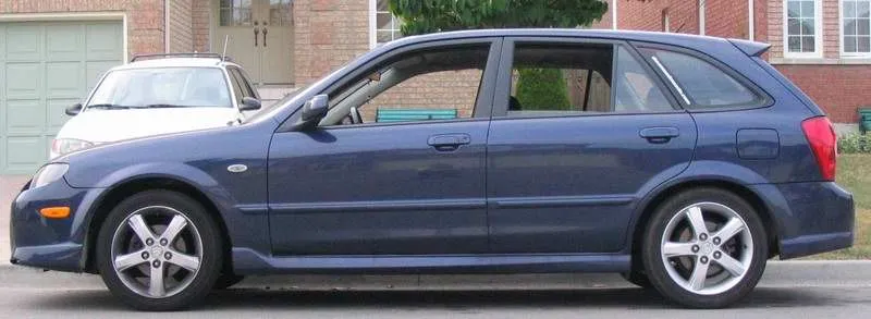

No ground clearance issues with mine, that was the deciding factor for me to get the MP3 springs. The 1st pic is with the car loaded down a LOT.
yeah, I think down the road Tokiko HPs will be planned. Pics look decent. I am runnin gon 17's, so it will be pretty good I think.
The aftermarket wheels in the pics are 17x7.5 subzero's. The MP3 springs are a great compromise.

thanks for your advice, Mike. The pic heavily loaded helps too. i haul dogs, and Sam's club in my car, cannot deal with being slammed.
No problem. I've never rubbed in the rear, even with the 17's and all the crap I put in the car....2 kids, the wife and all their stuff adds up. The woody does way better for the Costco runs though :)

And there is more of a drop on the rear than the front, but functionally they worked great.
