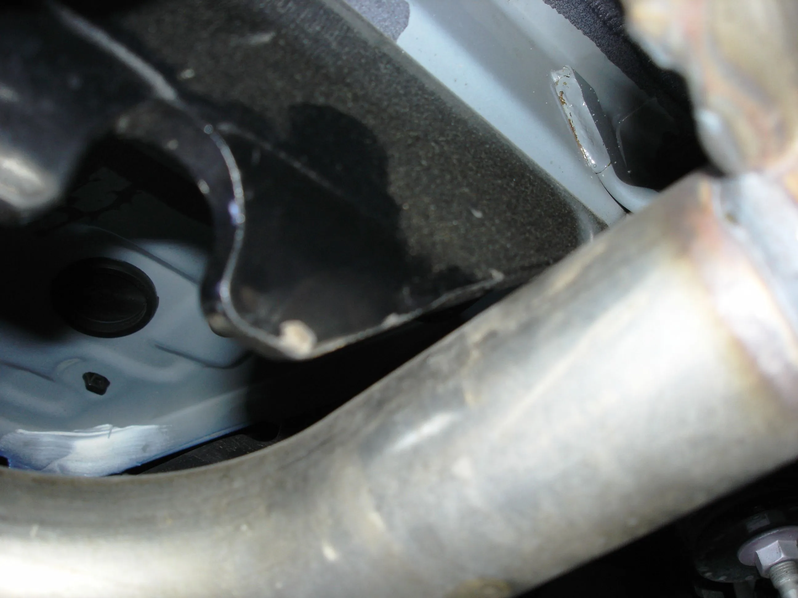

Can you post pictures of the clearance?
Never done this before; hope it works. Contact point I'm referring to is on the top of the tailpipe where the black "tang" passes over and behind it. Picture shows driver side, but it's the same on the passenger side and it sounds like my noise is coming from the passenger side. Right now I have about 3/8" clearance.
Thanks a lot. That's pretty close.

I noticed that from etrailers website, the class III receiver has curvy feature for exhaust clearance. I confirmed that mine has that feature too.
Class III
http://www.etrailer.com/Trailer-Hitch/Mazda/CX-5/2014/C13127.html?vehicleid=20148678
Mine
Class II receiver doesn't have that. And looking at your picture, it seems like it doesn't have either.
Class II
http://www.etrailer.com/Trailer-Hitch/Mazda/CX-5/2014/C12080.html?vehicleid=2014308720
Can you confirm this?
BTW, your receiver looks different from either Curt or etrailers website. Maybe they revised it?

Hwibowo: My hitch looks more similar to your 13127 (from what I can see in your photo) than the 12080 on Curt's web site. I suspect they've made more than one running change to these designs as I don't see any picture that looks identical to mine. All of this seems kind of academic at this point. Just be sure you get as much clearance as possible over and behind the tailpipes and keep a happy thought.
