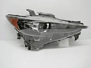

The headlight assembly is $600 and a single unit. Mazda does not sell replacement lens covers. Part number KL2J-51-031C:

OEM
Mazda only sells the headlight as an assembly.
The part numbers are as follows for the Left, there is one with and one without directional beam:
KL2J-51-041C
KL2L-51-041C
Purchasing new is your best bet to have peace of mind of a perfectly working new OEM unit. I would ask your nearby Mazda dealer's if you can purchase and pickup that part number from them. In my experience, some dealers do not want to let you do this and you may have to search online for Mazda Dealers Parts websites to see who has the best price including shipping. The dealer I linked above in my experience has the cheapest parts including shipping.
Another option is to search for the part number on eBay and see if there are good deals on used assemblies and sometimes there are Mazda dealers selling on there as well. Also check junkyards, other websites selling OEM, etc.

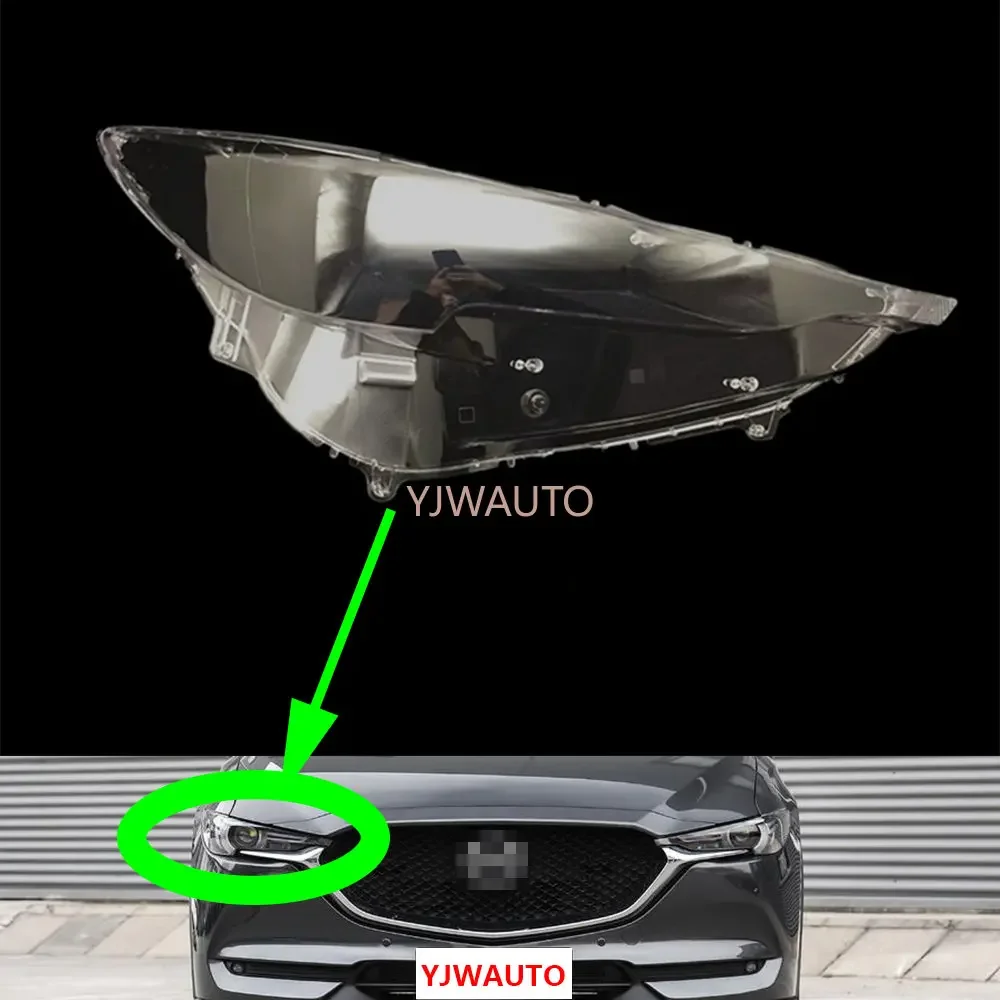

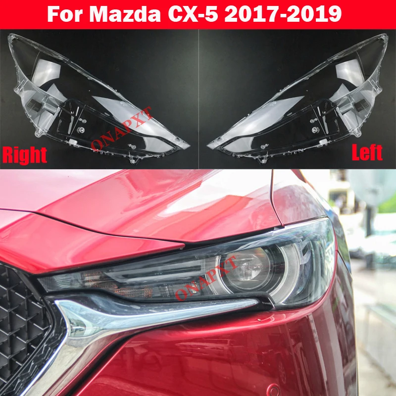

The final option is to purchase an aftermarket headlight lens from China. At ~$65 this is the cheapest and riskiest option, as you have to hope it fits perfectly, is shipped to you in one piece, and you will have to wait at least a month for shipping from China.
You will have to heat up your current headlight assembly, remove the lens, remove the old adhesive, add new adhesive, and attach the lens back. You can look up these videos on YouTube where people do headlight retrofits where they remove the lens and put it back.
