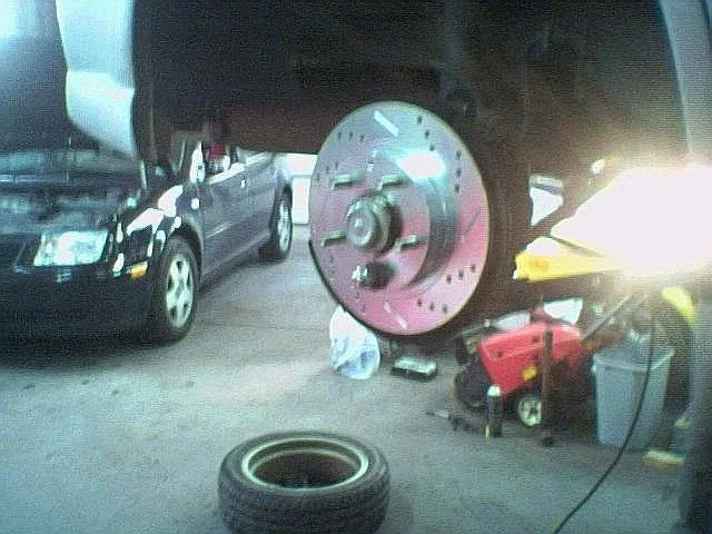

I got Brembo X-drilled/slotted rotors off of ebay, really like em. Definitely genuine, not knock offs.
Same here. Brembos C/S 195.00, Hawk HPSs 110.00, ss brake lines 65.00 all 4 wheels, shipped, prices off ebay. No cracked/warp rotors, no pad issues, nothin but kick ass pedal with ss lines. No problems whatsoever after 35k of "use" & not gentle use by any means. Still about 1/3 pads left. It will be time for rotors & pads when these pads finally wear out. There will be nothing left to turn rotorwise.....damn, did it again, no I have not purchased from the links above in particular but did purchase from ebay. There, answered the primary question-call off the thread police please.lol
