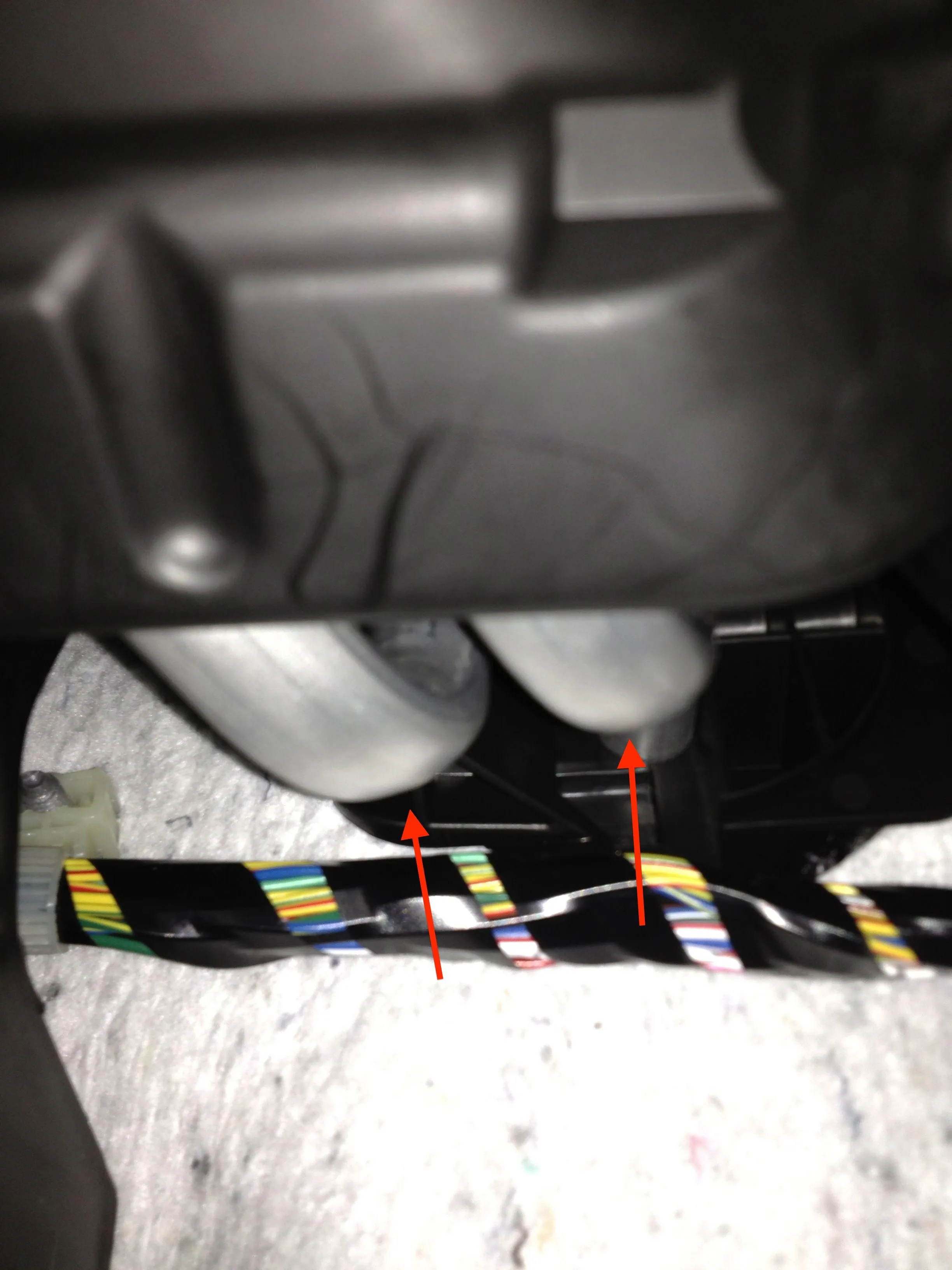

I was driving my buddy around today (first time I actually had a passenger in the CX-5). He's a tall fellow (6ft something), and was stretching out since we were on an extended cruise, when he recoiled rapidly and yelled at me that my car had shocked him.
I was very confused and was like, well don't try to touch whatever you did before. When we arrived at our destination, we looked a little closer underneath the glove box and found that it wasn't that he'd been shocked, but that he touched a RIDICULOUSLY HOT tube that for some reason is present, unprotected, underneath the dash on the passenger side. Check out the red arrows on the attached photo.
I assume these are maybe part of the engine coolant system?? What I don't understand is why it's so easy to touch them. If you sit normally in the passenger seat and stretch out in any reasonable way for a taller person it's not difficult at all to come into contact with these tubes.
This frankly is dangerous. This tubing is really really reeeeally hot. You'll get burned bad if you touch them for even a full second.
Is my car missing some shielding that is present on anyone else's CX-5s? If no, be careful where passengers with bare feet place them under the dash. I'm definitely going to talk to my dealer about this one because it's just begging for someone to be seriously hurt.

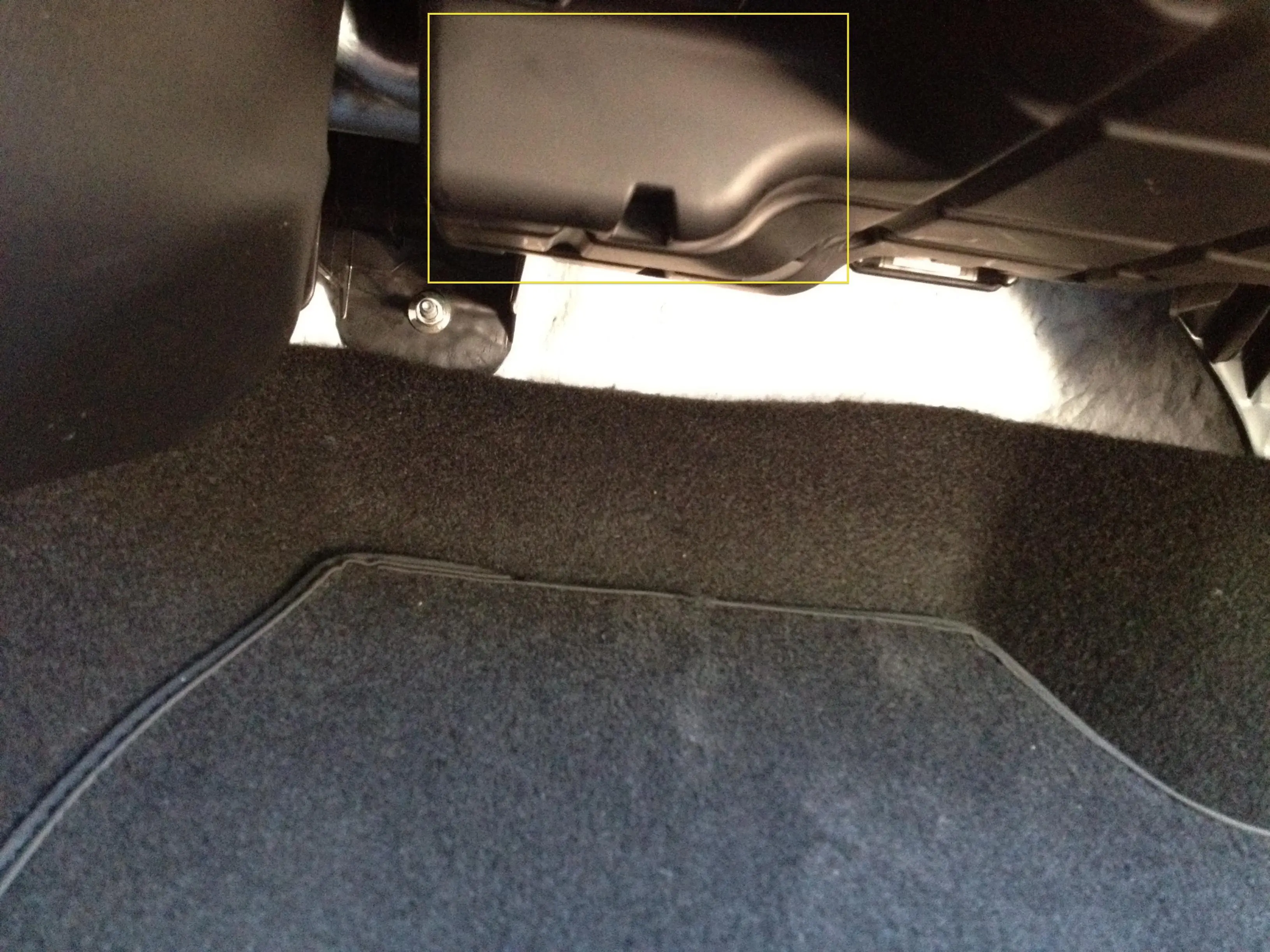

Good observation! Though I can't see where exactly that locates. Can you provide a broader picture? I may check it later.

Peskeguy It appears that the tubes take hot coolant to the heater part of the climate control, mine are also exposed! I put some soft black foam above the shield to cover mine based on your tip. MAZDA, The plastic shield needs to be LARGER and go to the firewall!!!
I attached a more zoomed out photo so you can see where I'm looking. This is passenger side under the dash. There's a plastic shield (outlined in yellow) that they put there to try to cover it up, but as you can see in the first photo, it doesn't cover them up at the back end where they run through the firewall.
Thanks Gaxibm, at least I know it's not just me. Yeah they obviously put the shield there in attempt to cover it, but as you say it's not extensive enough protection and it was hot enough that it could definitely hurt someone if they're unlucky enough to touch it.
I'm also tall at 6'3" and almost burned the top of my foot while stretching out.
