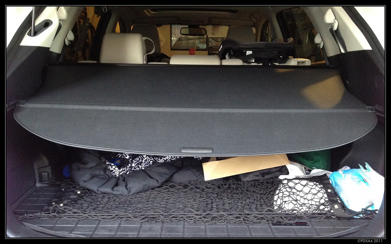

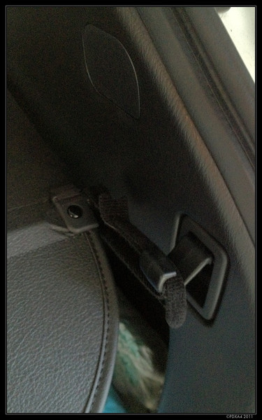

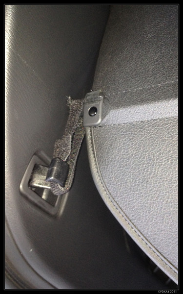

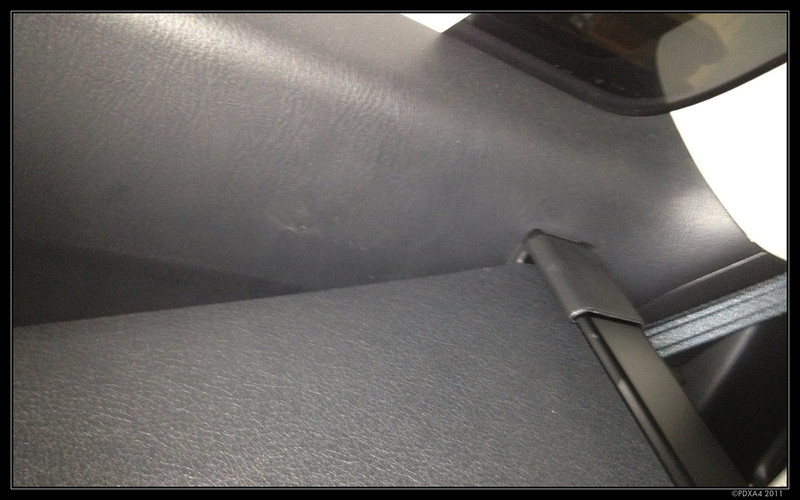

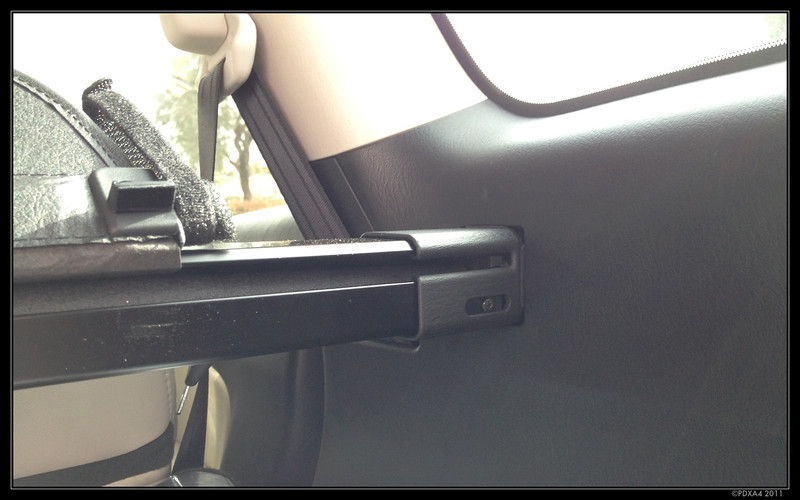

I had posted some pics previously of what I did on my car...
Temp solution, but it works good for us on a few roadtrips...
That's a good quick fix.
In pdxa4's last 2 picts, you can see an access cover for the brackets that are supposed to be used to secure the rear of the cargo cover. There in the upper right. These are level with the front support brackets, which all CX-9s have.
But on the power gate models there is no bracket on the rear left side. The lift gate motor is in there.
I would guess that any number of hooks could be added on the left side, to the surface, to hold the cover at the correct height.
