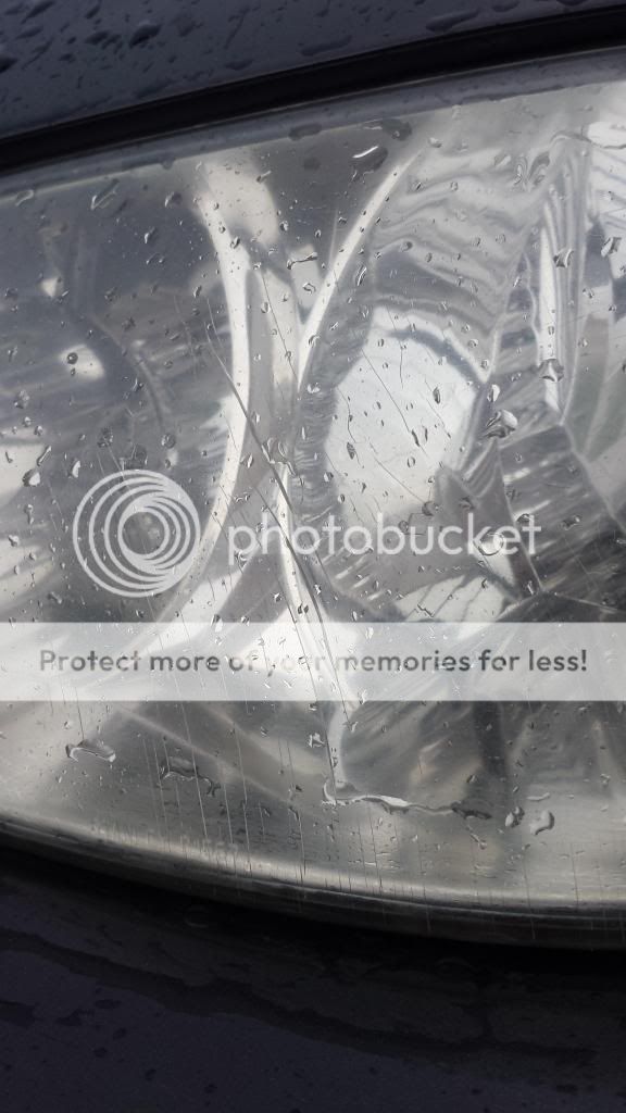

I think I know the cracks you're talking about. Really fine cracks that spiderweb from the inside. They're probably stress cracks that happen over time, and they probably won't sand out.
They're mostly going up and down inside the housing. I can remember if they're sideways other than curving with the lens surface, but they might be. I could see them being stress cracks though. Not good to look at.

BTW, I finally followed through on those light cracks. I couldn't get the greatest pics cuz I couldn't find a point to tell my camera where to focus, but this was probably the best one. If you need more pics, click and it'll take you to the album.

Those scratches don't look too nice. I couldn't tell ya what they are from though. mp5la might unfortunately be right...
I think I would like that setup. If nothing else, it'll be something I can add or get rid of. But honestly, I might just get rid of side marker lights all together (just headlights and turn signals). I like the way that P5s without side markers look at night, and it's something I wanna try. I'm thinking about replacing my bumper, but if I don't I'll just bondo them and take out the side markers. And if I get pulled over for it being illegal (doubtful), I'll punch out the holes and replace the holes with orange glass and put the bulb behind it. I hate the way our reflectors are on top of the bumper, instead of integrated. Looks dumb. Especially cuz one of mine is only 2/3 there.
And no, those headlights don't look good. However, they aren't as bad from a distance. I'm not sure how the projector headlights will show with this, but at least if I get the retroed sedan lights they hopefully won't have those. I think he is right, I just don't quite understand how they got there. I think they were there when I got the car, but I'm not sure.

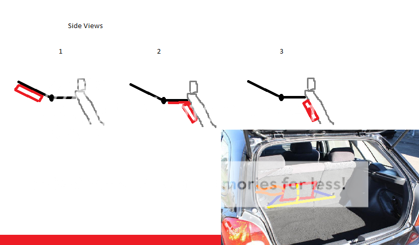

Well, insomnia has set in just in time for finals, and the last thing I wanna do instead of sleep is study, so I did a lot of brainstorming on things for Ozzie.
First, my audio setup. My roommate (as well as some coworkers) said they'd be willing to help me out, but haven't heard too much beyond wanting a new deck and putting a sub in my hatch. I was thinking about where I was gonna put the amp and came up with this idea, with a back story of course (What else do you expect from me?). Long story short, I accidentally left my cargo cover on top of my car after a bike ride and drove off without it. It was in my parking lot, but of course my dumb ass didn't realize where it was until the next night at work and by that point it was gone.
So my solution is this. I build a custom cover out of wood, layer on sound insulation, wrap it in fabric (maybe get someone to embroider something in there? Mazda logo?), and mount the amp to the bottom side. I would be using the same concept as the factory cover, with the same mounting/hinge point too, so the amp could be mounted in a few ways. 1) Mount it directly under the section closer to the hatch itself, although this would greatly increase the lifted weight of the cover when I open the hatch (just realized that as I typed it out ha). 2) Create some sort of folding bracket and mount it to the smaller section of the cover (closer to the seats) so that the amp itself would be on/parallel with (but not attached to) the rear seat. 3) Create a different mounting bracket that would attach to the bracket things in the back of the rear seat. However, seeing as I still need to have flexible space, the 3rd solution wouldn't be a permanent mounting. I would need a quick-release latch of some sort.
So these are my ideas illustrated with my master paint skills. (thumb)
Hopefully it makes a little bit more sense. No matter what, I'm going to need to put in another new hatch strut, and hopefully it'll be easier this time.

Hatch cover sub install => different, but interesting. The only thing is that you have to do a good job, or it will just look so-so. Mudflaps would be cool, but if you don't like the thought of driving with them in the Summer you might just let it be. IMO they're pretty sweet and even if they aren't stopping snow/salt they stop mud (because their name...) and water. And I'd check out the "flat" black of Plastidip on your winter rims. It might grow on you.
This was more what I was thinkin for the sub. I saw someone else put it into the hatch itself, and while it's cool lookin I don't wanna deal with that much wiring. haha

I know Circuit (Chris Bernardo, since you're in the Protege Chill Spot on FB) has his amps and crossovers on the back seat with a shallow mount 10" in the spare tire compartment. Looks really nice. I'll try and find the thread with the pics.
You dork for leaving the cover on the roof! Mine didn't come with one so there's that... $100 can net you one if you want but it's not a necessity I don't think. If you go with the compartment, I think the second option you have might work. If you can find an amp that suits your needs and is small enough, it would be a win-win. Not stuck on the back seats and no extra weight on the hatch cover...
You could also think about maybe fitting the amp under the hatch carpet as well as the sub (if you go shallow mount) Then you won't be taking up any space whatsoever
