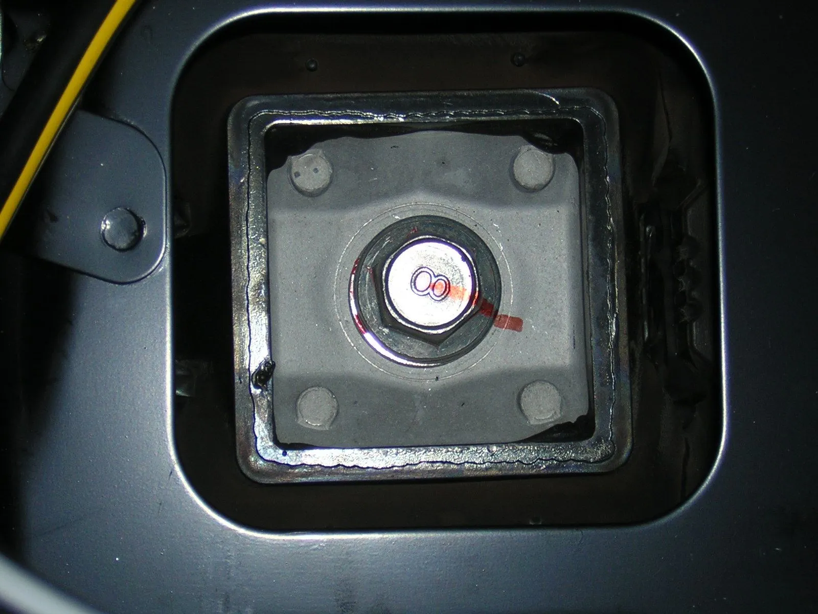

By the way I took 15min this AM before work and checked my bolt and its fine. I just looked at it and didnt wrench on it at all but the head of th ebolt is flush and tight to the spacer/washer so its all good. My build date is 02-07 so that may be partly why since it should have been addressed by that time.

First off SpeedI3 can you drive your car? if so the bolt isn't broken yet. when the motor fals it destroys a bunch of stuff.
Second the bolt used is only stamped with an 8. now if its was a american bolt i would assume grade 8, but since its metric and metric bolts use something like 10.8 and 12.8 for strength, i have no idea what this bolt is rated at.

Ok, it literally took 30 minutes and I stopped for a phone call. It's very easy and straight forward. A 10mm socket completes the entire job. Once I obtained access to the mount, I checked the torque (66 - 86 ft/lbs) and for mine, I immediately received a click of the torque wrench; wheeew, nice to know. I marked the bolt as you can see illustrated in the photo I provided. Lastly, my build date is 12/06.
1. Remove your battery cover
2. Remove a. positive and b. negative battery wires (In that order)
3. Remove the metal battery holding strap (2 nuts)
4. Remove the battery
5. Remove the the 3 bolts holding the battery box down
6. Remove the ECU top plastic cover only and unplug the ECU
7. Remove the clips holding down the positive and negative wires to the battery box
8. Remove the battery box and you have your mount. *Note your ECU will be attached to the side of the battery box so be super nice to it. :D
9. Install in reverse order
* Remember to plug the ECU in and reconnect the negative terminal prior to connecting the positive terminal. The positive terminal should be the last thing you install just prior to putting the battery cover back on.
10. Start you car and let it idle for at least 10 minutes.
If your bolt is backed out the slightest bit, I would immediately stop, call your dealer and have it towed. Stand firm and don't let them tell you to drive it in, that drive could be the difference between a good or very bad day.
I hope this helps...

If you guys are going to check it would it be worth it if I could find a high grade stud and nut for this? ARP could get something put together I am sure for this. Let me know if this would appeal to you guys.

Well here's the problem with that. If you modify the OEM bolt from it's original state with any "improved" bolt and that bolt happens to break, I'm willing to bet Mazda may say, "hey you installed an aftermarket bolt and the bill is on you." Sure there are a few options like a bolt & nut combination or even a bolt & nut with safety wire/cotter pin but...
After getting up close today, I personally believe the mount needs to be reengineered. The bolt should be horizontal from front to back, not vertical and absorbing the significant amount of pull that it has on it.

Yeah, I checked my Machinery's Handbbok and the SAE standard for bolt strengths and markings. if its an american bolt it should be stamped with dashes to represent the grade (5 dashes in a star for a grade 8, 3 dashes for a grade 5, etc)
A metric is supposed to be stamped in a numerical decimal fashion so if it were marked 12.9 the 12 represents 1/10 the min ult tensile in hundreds of megapascals. The .9 represents the ratio of minimum yield to min ultimate strength. so a metric bolt that is stamped 12.9 has a min ultimate strength of 1200 megapascals and a min yield strength of .9(1200) megapascals. One megapascal is about 145psi.
I have no idea what a single 8 stamped means

Good instructions, thanks! But when disconnecting the battery, ALWAYS disconect the negative first and then the positive. This may save you a nasty surprise. If you accidently touch something when disconnecting the negative, nothing happens. Once the negative is disconnected, disconnecting the positive is then also safe.
True, some habits are hard to break. I've just always used the golden rule of making sure things are grounded before applying electricity to them. However, what you said is correct and if your not paying attention, you can easily be (ZAPPO) reminded. (drinks)
