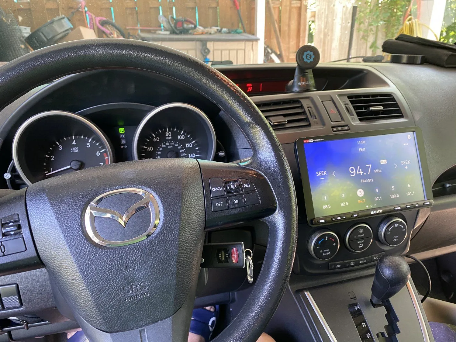

I did just replace the stereo in my ‘12 a few weeks ago. Back in ‘14 I installed a pioneer DA120 touchscreen unit, and it crappy out right as covid hit. Since we weren’t driving much I held of on replacing it until recently. I was looking at basically an updated version of what I’d had before, but all of the less expensive pioneer units were sold out (was sticking with pioneer so I wouldn’t have to rewire the harness. Ended up installing a ~9” floating display sony unit. More $ than these android units cost, and short on some features (No adjustable button colors, no second camera input, for some reason does a scrolling data display for radio despite having a huge screen), but I’m liking it so far. I was specifically buying something with CarPlay. Got it scratch and dent discounted to like $350 at crutchfield.... literally the box, and one manual had a scratch on them. Everything else was perfect. I ended up adjusting the screen out and tilting it down slightly after this picture was taken To help reduce glare.

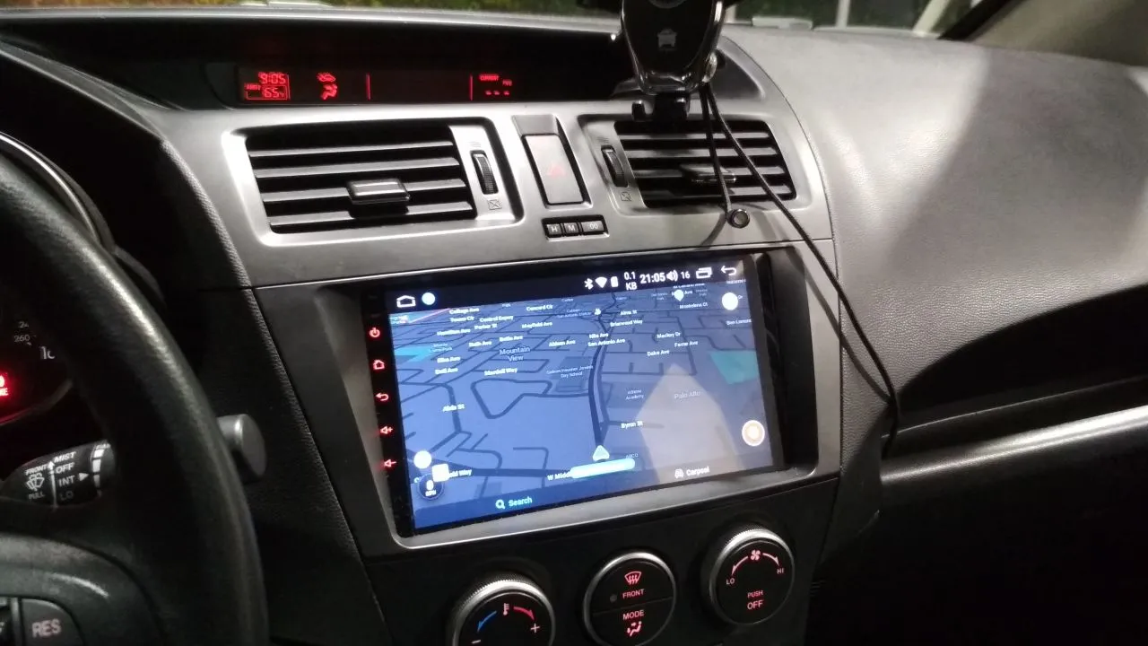

If I could choose, I'd go for a 7" unit with knobs and buttons rather than plain 9" unit. IMO, 9" is too big, - when I'm driving, my right hand on a wheel blocks visibility of the corner of the screen where Waze shows speed limit, this is a major inconvenience. IMO, PX6 units are better than Intel and are worth extra dollar. Don't be cheap on the screen, try to buy a unit with "IPS" screen.
Well, I'm in Cali, so no real winter here. Russians from 4PDA generally say they have no problem with their head units. Which may differ by model, of course. Some crappy head units will glitch. Good head units won't.
Mine from kanor (not the one on the photo) been around almost 2 years, another unit I installed - been used 3 years, nothing to complain so far. Waze works, android gets updates. I predict the life cycle of such unit is around 3-5 years, depending on your needs. Android will stop supporting it at some point, but it would still be operational otherwise.
