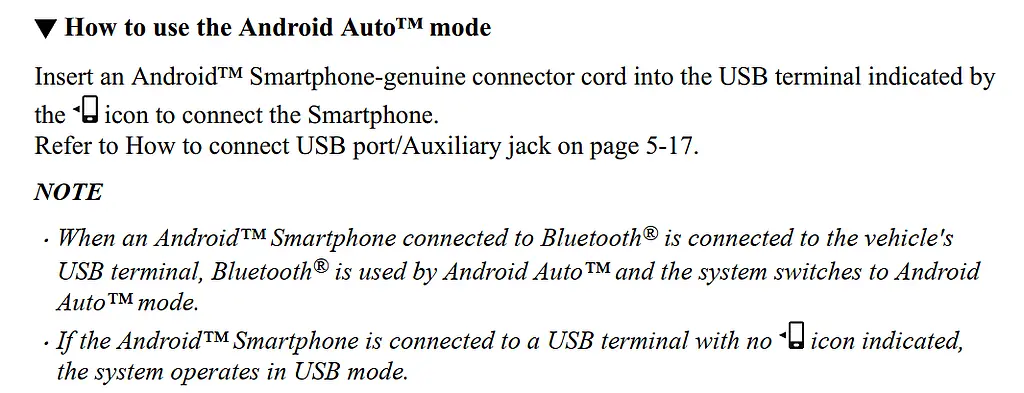

I would love to know how to connect via a wire. I purchased a data wire and tried to connect to the port in the armrest but on the screen, the USB options are grayed out.
There are two ports in the armrest, but only one of them supports AA. Are you sure you're plugged in the correct one?
on 2022-- any port supports anything. Doesnt mater. Problem could be in the wireless adapter. Some have firmware updates, etc. Did you check with the manufacturer?
Nope. See the manual section below:
