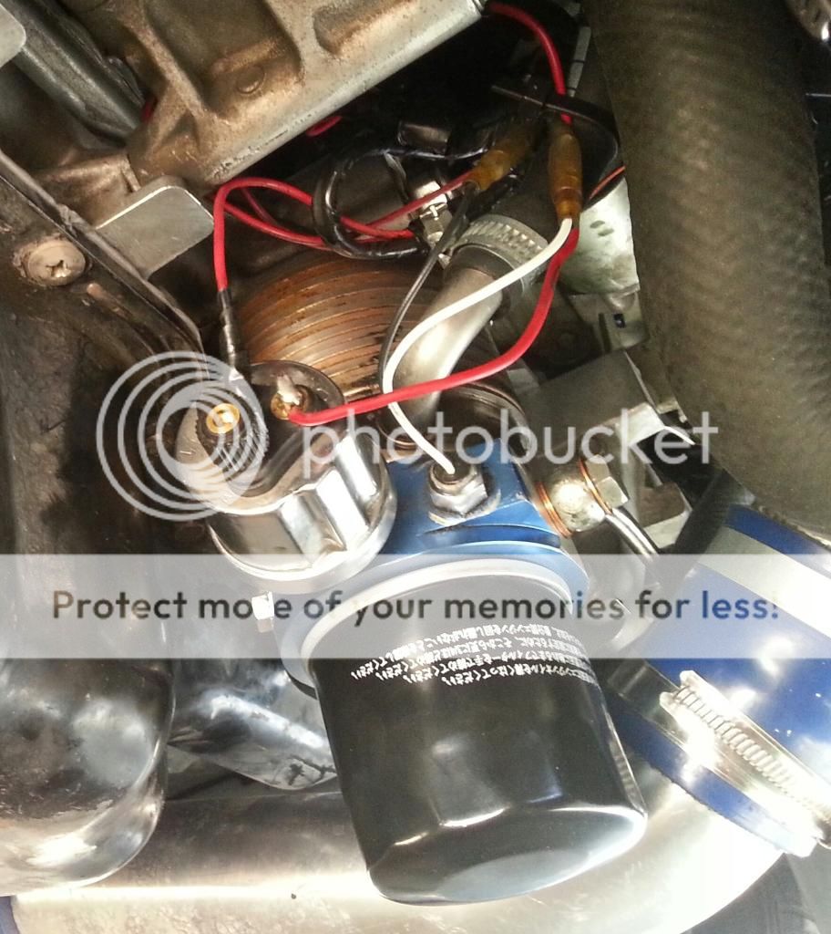

I installed an oil cooler heat exchanger from a subaru forester.
Its the big one that subaru uses and the filter now sits just under the oil pan. so i am gonna remove the sandwich plate and I will use the stock oil pressure switch feed for the turbo and the sensors.

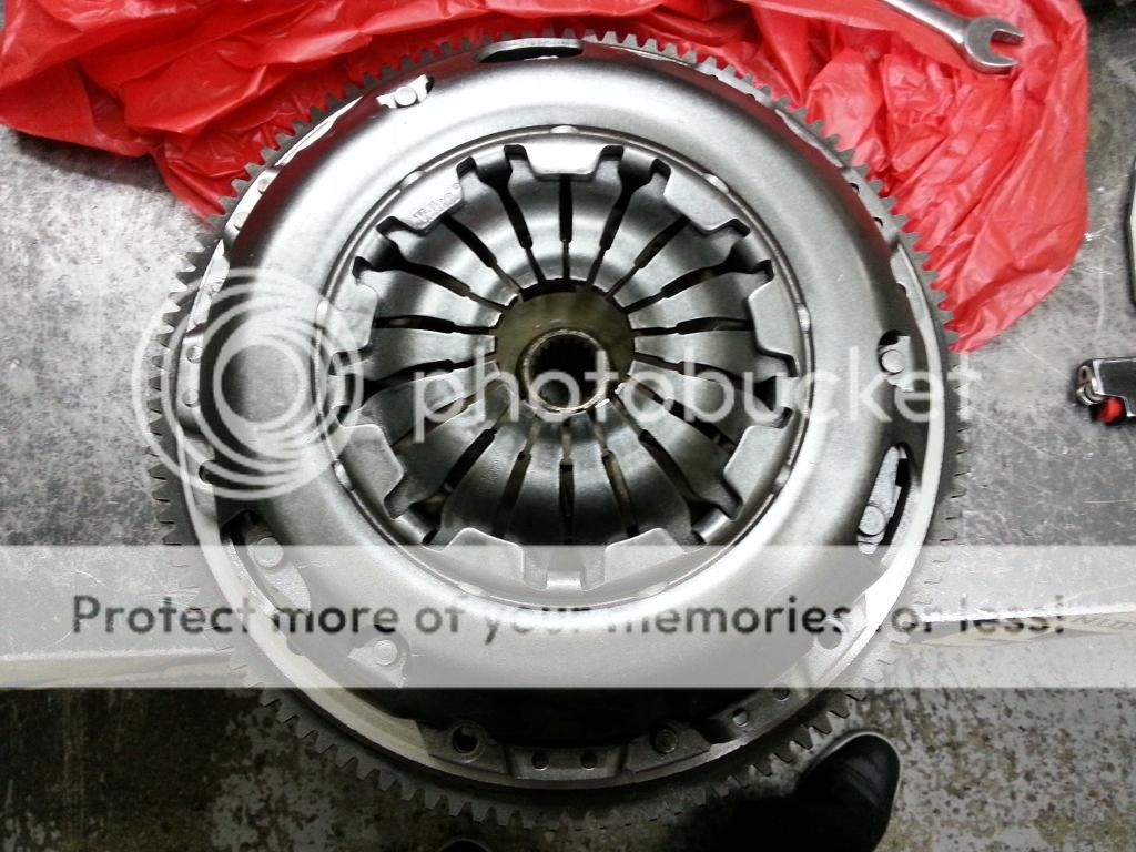

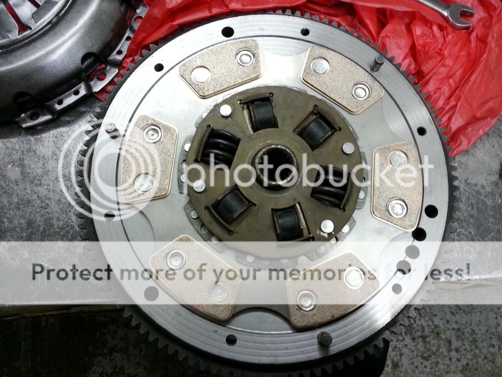

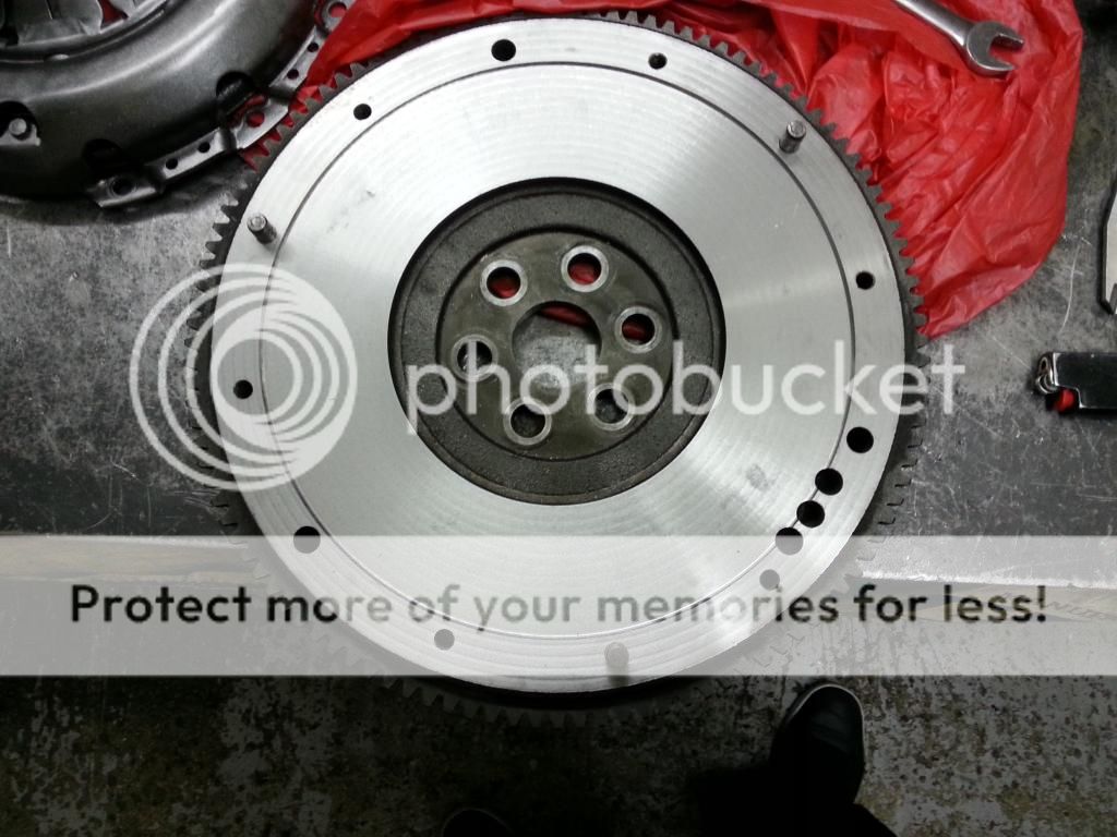

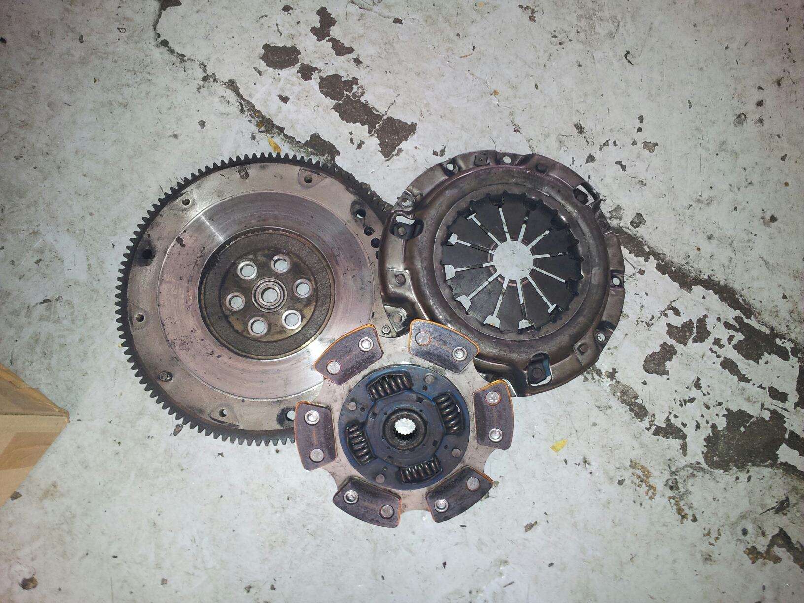

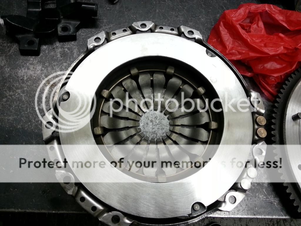

With the clutch configuration(Exedy plate stage 1 and sprung 6-puck 200mm with miata 1.6 flywheel) that I am running I had clutch slipping on fast gear changes.
The new setup is 215mm clutch disk 6 puck sprung with an unknown to me pressure plate.It's a valeo but I have no idea from what car. The configuration is totally different from the stock one.
The one that I am running:
