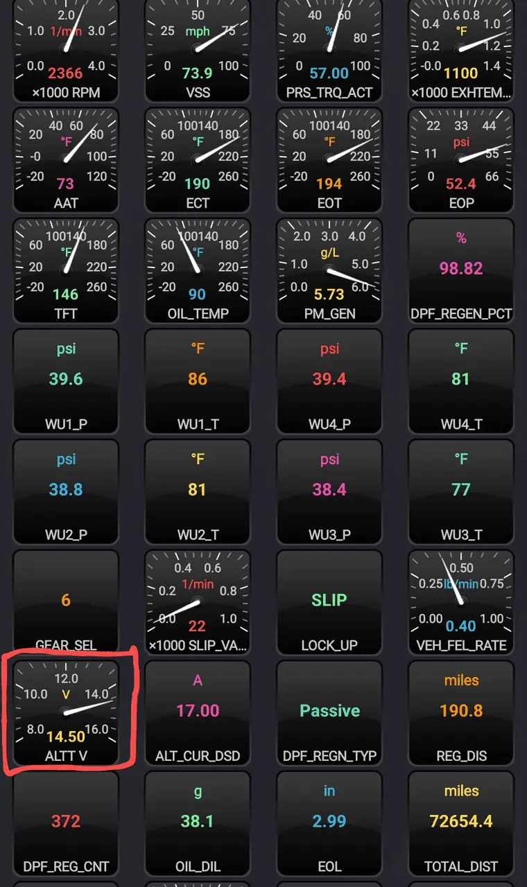

As a data point, I typically see right around 14.5 volts on our 2019 diesel.
