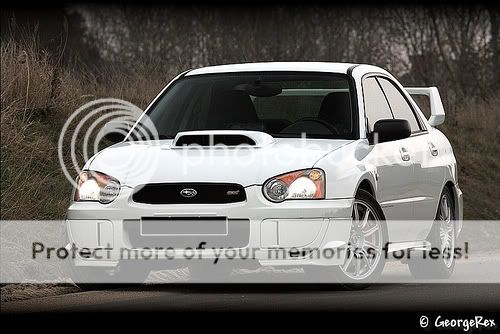

This should be your favorite bodystyle 22B Impreza...needs bigger wheels though...:-P
Nope,
Just add fogs. yummm.
Hmmm yeah I almost bought one just like that in white too but decided on the speed instead...I found a pristine one too with 15,000 miles for like 22,000...but it was modded :( so you knwo it was ragged on. Plus early STi's had problems with first gear synchros....
