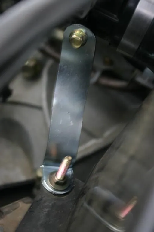

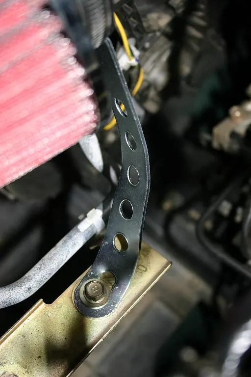

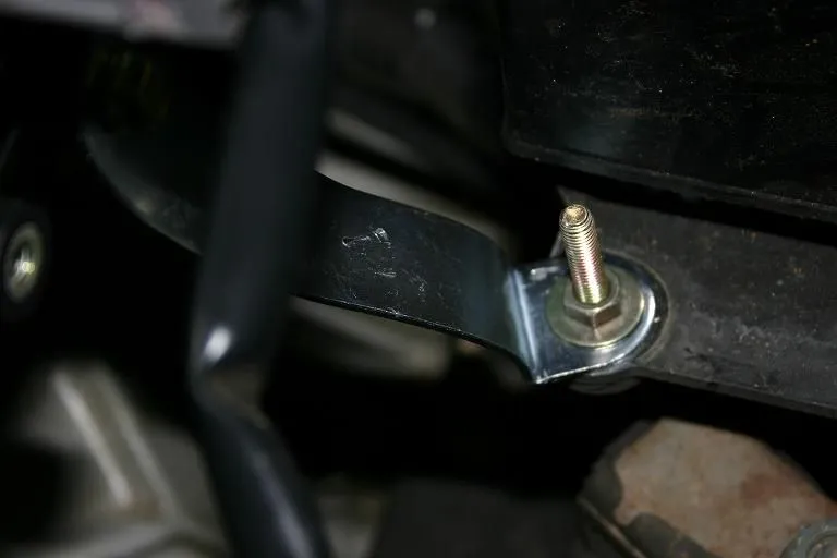

You are going to need to bend the long flat metal peice and bolt it down in the already existing hole. Hope these pics help.
