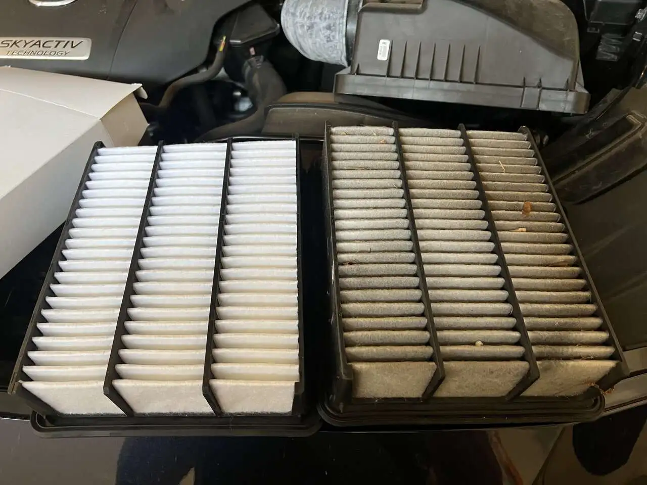

This is the one I used, it fits perfectly. Note that the non-turbo engine uses a different filter element.
Fram CA12167

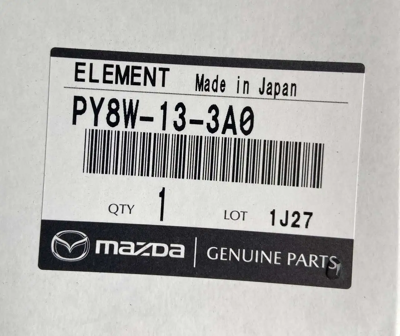

PY8W-13-3A0
From the dealer. Made in Japan, so you know it's quality. For a 2021 CX-5 GT Turbo.

PY8W-13-3A0
