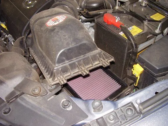

Anyone know how to remove the cover for the air filter? I saw the two tabs, but not sure how to remove the cover after that.
Undo the two clips.
Slide the cover to the left.
Lift and set up on the tab in front of it.
Change/Clean Filter
Place the cover back on.
Slide to the right.
Press the bow of the clip to reinstall.

Cover won't slide shut...
Ok guys... I just received my OEM filter (CY01-13-Z40A). Took out the old/dirty filter (orange rubber) and put in the new one (black rubber). When I tried sliding the cover back on, it does not slide back into the three slots. It's seems the new filter is sitting a little bit higher than the old one, making it practically impossible to slide the cover closed.
Along the edge on the old filter had like a notch all the way around (where the filter material met the rubber), and this notch fits over a ridge that is inside the "Air Cleaner Body" compartment. This notch causes the filter to sit lower in the compartment, allowing the cover to slide closed practically effortlessly.
The new filter does not have the notch around it and thus it seems to sit higher, which forces you to try applying extreme pressure to try sliding shut into the three holes. When I look closely I can't understand why, but that's my theory.
Has anyone encountered this or heard of it? Am I missing something? Please help!!!!

I don't think you need to unplug the MAF. You just life the cover high enough to remove/put in the filters.
I have the K&N. The edge is also significantly thicker than the OE filter. I had to apply a fair amount of downward force to slide the cover
back into the slots.
I use a fram air filter and it is exactly the same as the original filter i pulled out even the color. I had no problems putting the cover back on.
