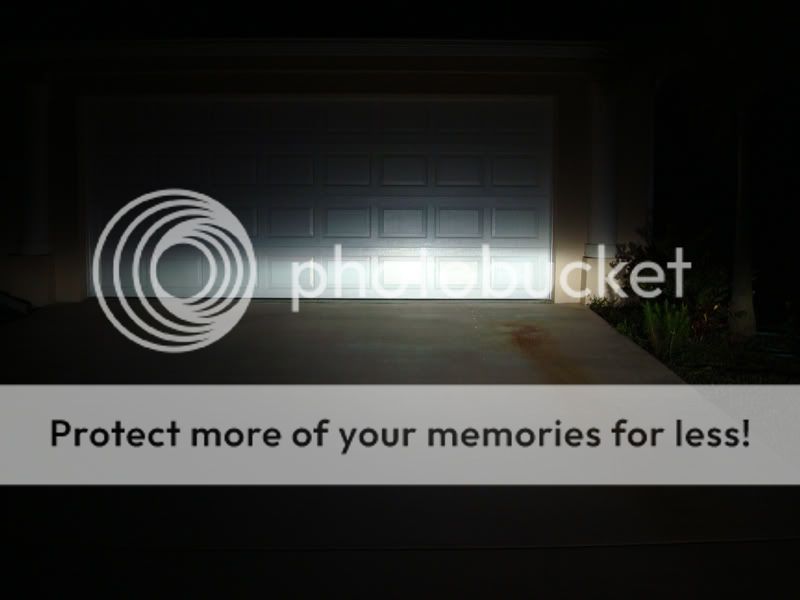

Anyone have pics of what the cutoff is supposed to look like against a flat wall (I heard the passenger side is supposed to sit higher)? Stock housing if possible.
On the DDM kit I had to trim off one of the tabs on the spacer. Maybe I was just not patient enough and didn't want to mess around with it. But the bulbs sit in the housing correctly and they're aimed as close to perfect as I can get them. They were really close to begin with, so that leads me to believe I installed them correctly.
best i can getcha
trim tabs??
That's just the Apexcone DDM slim kit slapped into the stock hsouings
and THIS is how the cutoff should look after a REAL conversion. lol
