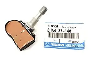

Please note that the part number for 2017 ~ 2020 Mazda CX-5 OEM TPMS sensor is BHA4-37-140 or BHA4-37-140A, not BBM2-37-140B. If you enter part number BBM2-37-140B into any Mazda parts website, you’ll see a warning message saying “This part does not fit your 2019 Mazda CX-5”!

The TPMS sensor currently sold by Tire Rack which is said to be compatible to older BBM2-37-140B, looks different from OEM TPMS sensor BHA4-37-140A which is supposed to be made by Pirelli. And the price is not much lower than OEM.
If you want aftermarket TPMS sensors, it may be better off to get Autel MX-Sensor 2 in 1 (315MHz + 433MHz) Clamp-in TPMS Programmable Sensor for about $25 ~ $30 each. Just make sure they have been programmed to be Mazda TPMS compatible. As for getting used ones, the only thing I’d worry about is how much battery life they may still have.

Also, mazdaswag shows that the BHA4-37-140A sensor is compatible with the CX-3, CX-5, CX-9, MX-5, and Mazda6. The BBM2-37-140B sensor appears to have been superseded by the BHA4-37-140A sensor. If you choose to buy the BBM2-37-140A/B sensors, they should still work, but you need to check the ad/item description to see if they are refurbished/used/old inventory. Until someone can confirm that the BBM2-37-140B/A sensor works on the 2019 CX-5, it's probably safer to go for the BHA4 sensors or the Autel sensors.
