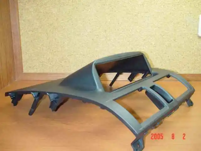

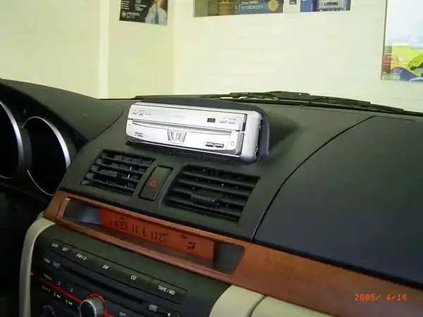

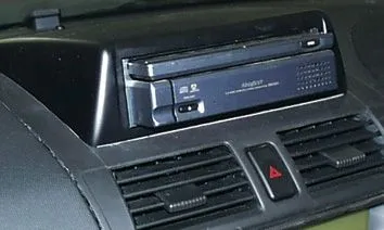

After doing some research, I am thinking that I am going to go with the Pioneer AVIC-N2. I was contemplating building a carputer but then I thought about all the time and effort and realized that for $1250 the pioneer isnt bad at all, and it doesnt rely on my skill (or lack there of) to build. My plans were just to use it for gps, dvd, and possibly upload my itunes anyway, but the pioneer does it all in one(minus itunes, but has an ipod adapter), and would probably consume less power, which was a concern of mine. I also think that if I went the carputer way I would have spent alot more also. Im not downing the carputer, I just think for what I am looking for, the carputer isnt the way to go.
I still have 2 questions:
Can I set up the AVIC-N2 using this piece while still keeping my stock controls? Cause Im not going to use it for music really, unless I connect my ipod to it possibly.
Also, in djltoronto's pic i saw him put the main chassis where I want to put the Monitor (under the dash piece). Would it fit in the glove box?
Dimensions (Main Chassis) 7" x 2" x 6-1/2". I dont know the specs of the glove box :(
Is it me or does the same kind of piece at mazdaspeed suck?
And its more expensive...
