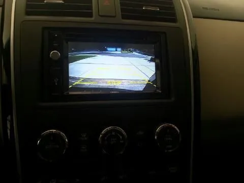

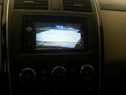

Congrats! Any pics of the install?
I have two that I did from the rear view camera picture. Not the best view. If you would like to see more let me know.
