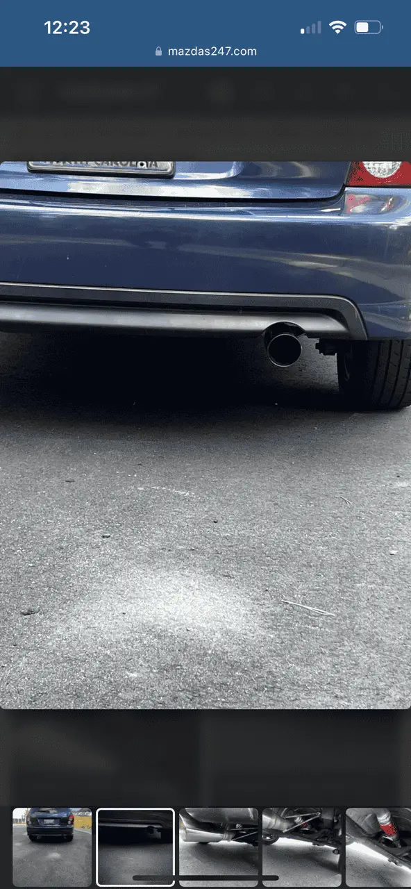

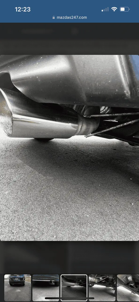

Update for all
Because I’m impatient, I went to my local exhaust shop and made some choices. I was going to do the Magnaflow muffler with 3” double wall tip but it would’ve been like 300 dollars since apparently Magnaflow increased prices per my shop. They also said, many times people who choose Magnaflow expect it to be louder so they end up coming back to remove resonators so I’d be in it for more money
the shop, based on what I explained, said I could go with an 8” cherry bomb Glasspack and a 3” double wall tip so that’s what I did. Paid like 160 for everything. I went by and paid and started it up, surprisingly it’s not that loud. I’m guessing these resonators are very restrictive. I haven’t driven it other than reving it up but it’s mellow and not ricey or loud at all. I hear more of my engine than the actual exhaust
Anyone who is on the fence, it’s fairly cheap and not loud. I’ll have more information as far as drone once I start driving it but first impression is I thought it would be louder so I’ll probably look into a cat delete or resonator

So I originally I did the 8” Glasspack instead of the stock muffler. Sounded nice. Wasn’t too loud but was subtle. However, about a month ago, all my cats got clogged. So 1000$ later, I replaced my primary cat and downpipe, deleted my second cat. Left the resonator and kept the same Glasspack. All it did was open it up more. I’m happy with both
There’s another thread where I posted photos and sound clips. I’ll try to add it here
