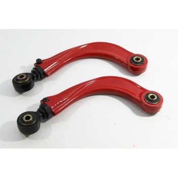

The Mazda5 tends to have too much negative camber which will eat through rear tires. When I got our '06 aligned, the rear was at around -2.5 deg, way too much! I decided to replace the stock upper camber link with an adjustable part to preserve the tires. First step - purchase adjustable rear camber link

At this point, you can just remove the outer bolt, then the camber link. Now, time for some math! I had 2.5 deg of negative camber, and wanted around 1 degree, so needed to add 1.5 deg. A rough measurement from the approximate lower axis (lining up the bolt for the lower arm with the bottom spring perch & the toe control arm's bolt) that the hub pivots around up to the mounting point for the camber link was 190mm (green in drawing), and the existing length was 285mm. Adding 1.5 deg of camber meant that I needed to add 5mm to the length of the link. This is also end-to-end linear length, not additional length of threads in the adjustment, since the link itself (purple) is curved.
ZPa715E1AtuUcWIvHpfutR4MNFdgbus6LgrjDbgP_xeZSXqCA6Hm4c2Phz1hy5uzw-6AJatJoSjoWw3u2_ITOuAVWrY2acsPXmCaV21qCxcW_ZX2cBsPAKz-ITo0QuMbqmD66edKzpgF6EZR2UFUeyBDUNfj5SZReoBc5LT2A6Xfdxpk_yFf5aC8iH8CHosxDM8quZ0djeBFbNIOnFGriwgB7kA7kqXWTbO7HqEg-JLO9A4IXVmY7q-jR53pG1wMKFKmh5bZX_-NdY3eeKZ2BBl_GXZe_9qxAsnNFHx6ybQzAP0bOxtGsa2a8trWAKXAuC-8h2bK62zexXcjo8Ozns_y8tSknIvXGNnL820bbEzu_2Cc1Oq49N2HygnN24rAzg_iWiInV2l8Tb0caAY7lNhVAsgi8K0EdwSGDwBEVk2el9KeHVu8HyXof7_s9Xj_bcmWvH7BTycudFnalah6C_ahDw2h2F7krqKSe_ZFzdBDx16vNOnX_pyPS8mhWUyM_Ln7JYMr1NDJEXCd399TWDEc-AOxZbSIoTbiapb-EirVl5v-iJB_mQckOBvnIEKRg6mK=w789-h712-no
So, move the adjuster on the new linkages to get 290mm between the bolt holes (measure from the middle to middle, left-edge to left-edge, or right-edge to right-edge of the bolt holes). Tighten down the lock-nut and the allen-head to hold the adjustment.
Remember to use loc-tite on all the suspension mounting bolts, and I used anti-seize on the subframe mounting bolts to make sure that they wouldn't stick next time. I cleaned off the spots where the subframe touches the body to keep from trapping dirt & grit in there that could later form more rust, and could possibly allow some misalignment.
Overall, this took about 3 hours total with basic hand tools in the apartment parking lot, although some of that time was finding the inner front mounting bolts - i forgot about them initially.
5mm actually took out about 1.2 degrees - some of this is because the lower axis that the hub rotates around isn't flat, so some adjustment of the camber link actually changes the toe slightly. Also, I was estimating a lot of the angles involved in the math, so things could be off a little bit. However, 1.3 deg negative camber in back isn't bad, and now that I know that 5mm = 1.2 deg of change, I can go back in and readjust.
