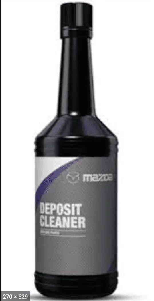

When I retrieved my Signature from Mazda the other day following the 10,000 kilometer maintenance the service manager handed me a product called " Deposit Cleaner" labeled "Mazda" and told me to pour it in the tank at the next fill up. Anyone else been supplied this product and advised to do this?

Thanks for the replies. Unfortunately I didn't take a picture of the bottle before pitching it but as I say it was a product labeled Mazda.
I found a picture of it.
