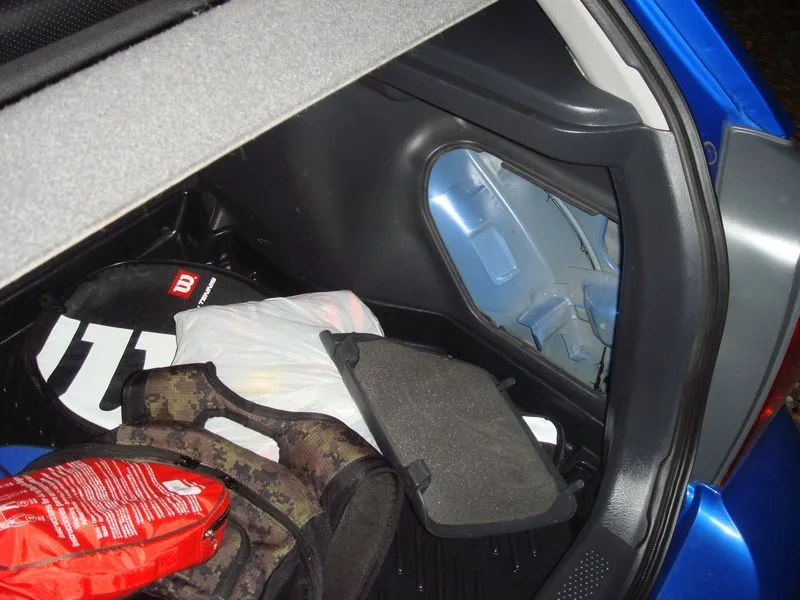

OK one more, here is for the missing jack, does this photo looks weird? If so, tell me where I can buy another set of jack/wrench and all that for the spare tire...

Mine is 06/03 prod date. It has racks, sub, single CD, no sunroof. That 2nd pic is where the jack would be. The handle would pop into the tray on the drivers side under carpeted floor over spare tire. Sub would be in the spare tire rim area & that 1st pic is not the wiring harness for the sub. That looks like the door pin wiring. The sub harness has more wires and is wrapped up in black.

Well that cover extends all the way to the back, include the trunk light and all that...I can't seem to find a way to take it off...

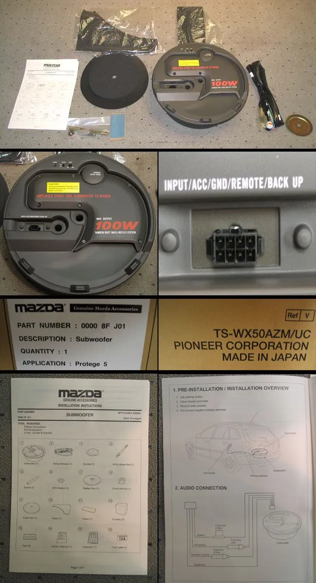

It wasn't hard at all to install it. I'd suggest buying the sub with the wiring harness. I got mine off ebay brand new. Some people sell their OEM ones without the harness.
Here's the picture of the complete rear sub only package WITHOUT the floor risers/trunk organizer boxes.
You've got to raise the rear trunk floor about 2 inches so you lose out in some spacing.
You'll need those rear trunk organizers to help raise the floor, unless you like to use some thick styrofoam instead.
