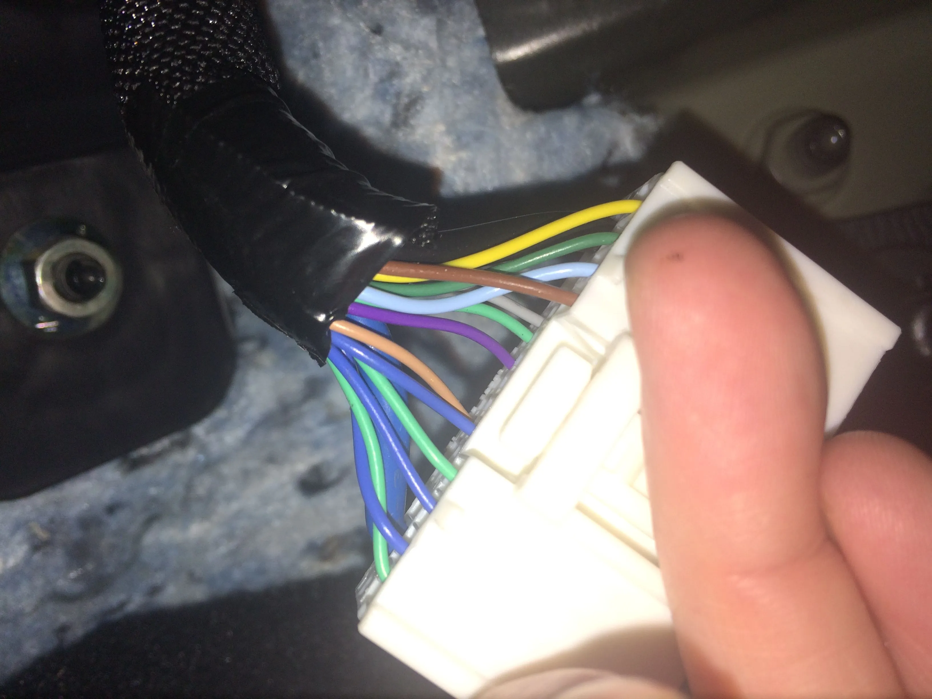

Hi all, I have a 2015 Mazda 2 GT-M (EU model) and I would like to add an active Pioneer TS-WX710A subwoofer to the factory audio system. I have never done this before, so I have done some research, but still remain with some questions. The subwoofer has an internal hi-lo converter and I am planning to take the signal from the rear speakers. I have found many wiring diagrams, but not of them has the same colour scheme as mine.
Question 1:
This is my TAU connector:
Is it correct that the yellow, green, blue and brown cables near my finger go to the rear speakers and is it here that I can cut them?

1. A friend of mine has used one of these adapters before, cut out one of the back speakers and fit this adapter to connect to the sub using RCA cables https://www.amazon.co.uk/dp/B004UA753G/ref=wl_it_dp_o_pd_nS_ttl?_encoding=UTF8&colid=2PU8IEHF8LCCU&coliid=ITRMI87S6MZC6
