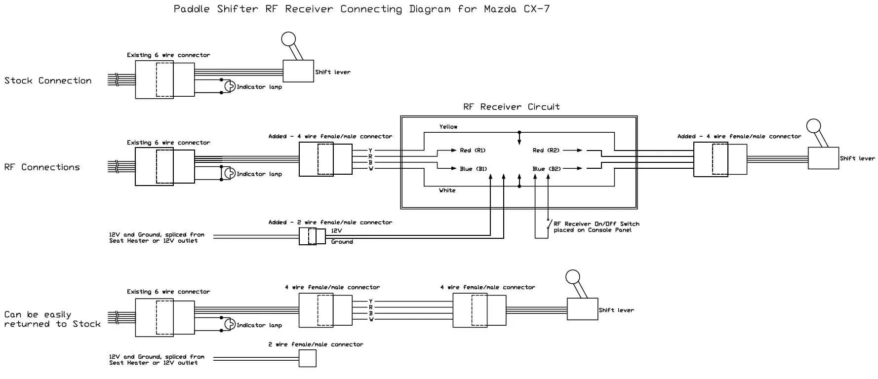

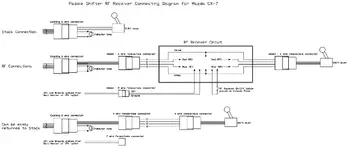

Next I cut the four wires: Yellow, White, Red, and Blue about four inches after they come out of the 6-wire connector, and soldered extensions of about 12 to each. To the end of this I attached a 4-wire female quick connector.
On the other end of the four cut wires (the wires that go to the shift lever) I soldered extensions and attached a 4-wire male quick connector.
When the two 4-wire female/male connectors are attached, the car functions normally.
To get 12V power, I spliced a wire onto the seat heater 12V supply that was conveniently beside the shift lever (Fat pink wire, though cant remember which one, as there are two in each seat heater switch pair) You could also use the 12V wire from the 12V Power Connector. I also spliced a wire onto the Ground on the seat heater connector (one of the Black wires), you could also use the ground from the 12V Power Connector.
Note: TEST these wires yourself using a multimeter to be sure youre using the right 12V and Ground. 12V should be only on when the key is in the ON position. The Ground should have zero resistance to any other grounded metal part of the car.
To the 12V and Ground wires, I attached a 2-wire female quick connector, and connected the other side of the 2-wire male quick connector to two 18 long wires.

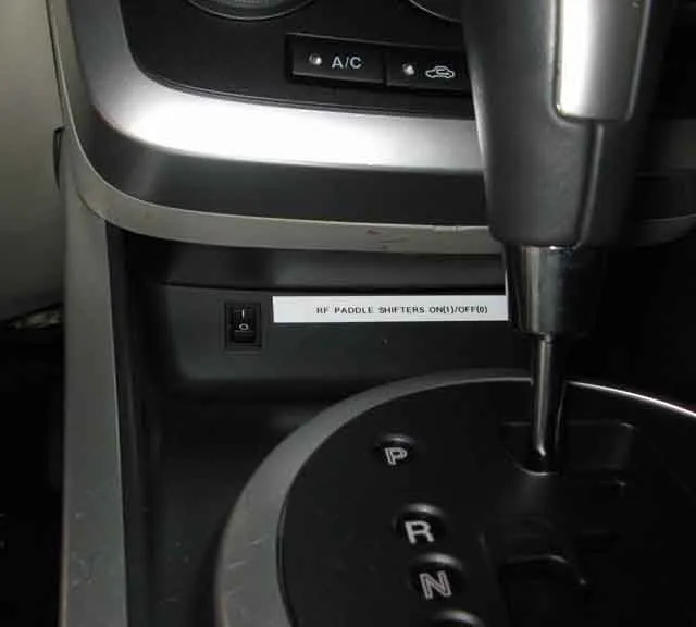

I attached an ON/OFF switch to the front of the removed shift lever console, so it is below the radio/heater. It cannot easily be seen here, and its quite easy to attach to the removed panel. I wanted a switch to turn off the modifications in case of radio interference, or if someone unfamiliar is going to be using the car.
To the ON/OFF switch, I attached another 2-wire male quick connector, and connected the 2-wire female quick connector to two more wires
Note: As there are now two pairs of 2-wire quick connectors, I modified one so it can only connect to its own pair. You may want to take some similar precaution in your connections so you will prevent attaching the wrong connectors together.
The end result should be a set of connections that only attach together in one way, and can be easily returned to stock condition (although with some extra connectors in the middle).

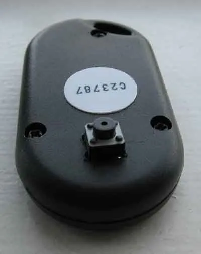

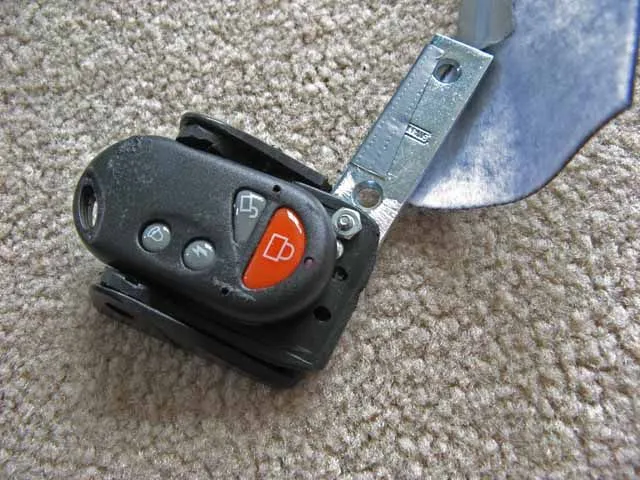

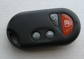

You can find a RF receiver with two remote transmitters at electronic stores. I got mine from a remote battery-disconnect device from the auto-supply store (I would recommend the electronic store as its likely around $20 and they may be able to help with the connections). What you need are two paired key-chain transmitters with at least two buttons each, and the receiver circuit board, which is likely about two inches by three inches in size. I found that my device had a 12V power input, and a ground wire. Two connections on the board outputted very low power 5V signals, when the remote buttons were pressed.

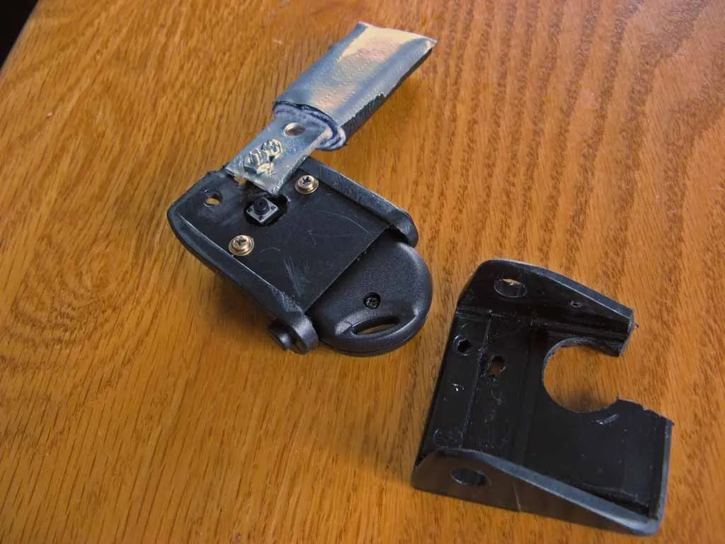

On each transmitter I desoldered and removed all the buttons, and wired in a small click-button in the middle of the outside. Make sure that the upshift transmitter and downshift transmitter have their buttons wired to different signals. You dont have to remove the buttons if you can find a good way to press the buttons as they are.
Mounting the Transmitters:
There are many ways you can mount them. Drill or screw into the plastic, glue, velcro, or whatever. You could put them on the front, back or top of the wheel.
I wanted something non-marring, and strong so this is how I did mine:

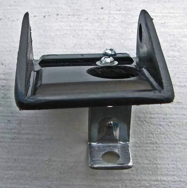

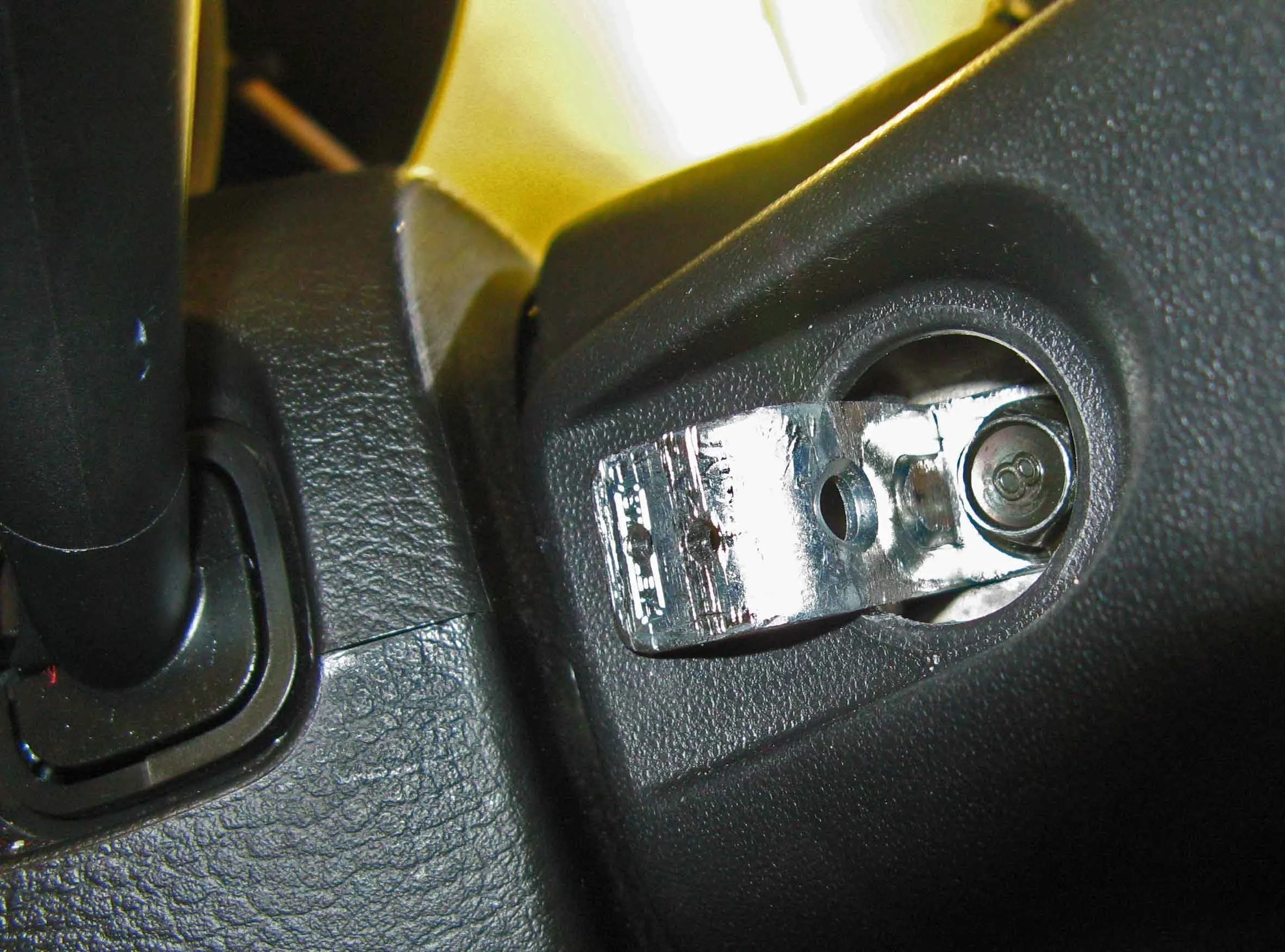

Remove the rubber plugs from the back of the steering wheel. The bolts inside keep the airbag attached to the steering wheel. If you only undo one at a time, you should be fine. (if, like me, you lose a bolt inside the steering wheel, youll have to remove both, and then the airbag wires, to go fishing for the bolt. Make sure to first remove the battery cable & pump the brakes to remove residual stored power. In fact you should be removing the battery cable anyway, while doing this whole installation)
After removing one bolt, I made a Z out of flat metal with nearly 90 degree bends. On one end I drilled a large hole the bolt can go through. The bolt will attach the Z firmly to the wheel and the outside arm can be bent flat against the wheel, in the recessed cavity pointing away from the steering wheel. The metal has to be fairly thin to allow the bolt to have enough grip into its hole, as there are not many threads. Somewhere around 1/32 or less. I used metal from a hardware corner brace.

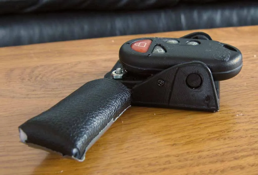

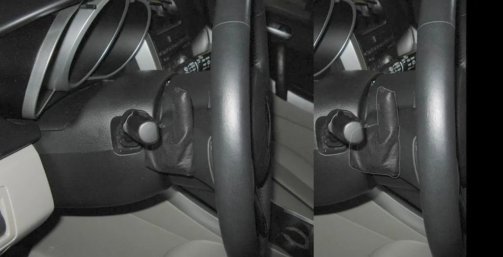

I found some cam-buckles from the camping store that are black plastic like the steering wheel, very strong, and a transmitter could fit inside. I had to cut away a good deal of plastic to get them to fit well, and fit snugly against the steering wheel. The cam-buckle mounts get attached to the Z with small bolts.
Attach the transmitter to the cam lever. I flipped the lever upside down, and screwed on the transmitter. When the cam-lever is pressed against the cam-buckle mount, the button is clicked.

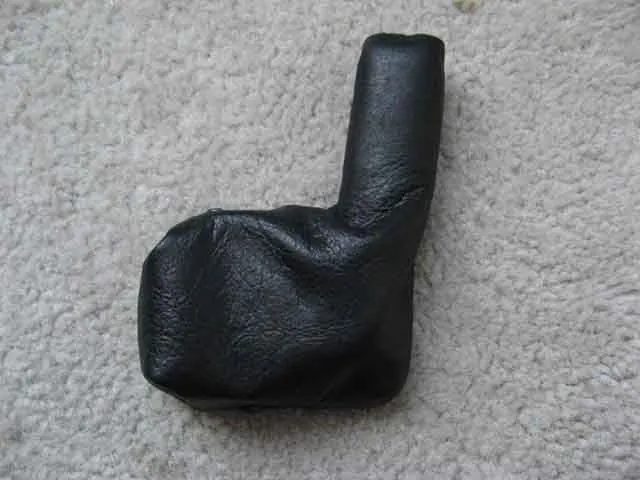

Then attach a vertical post to use as the shift paddle.
I wrapped the post with soft material
And covered the visible portion with soft leather

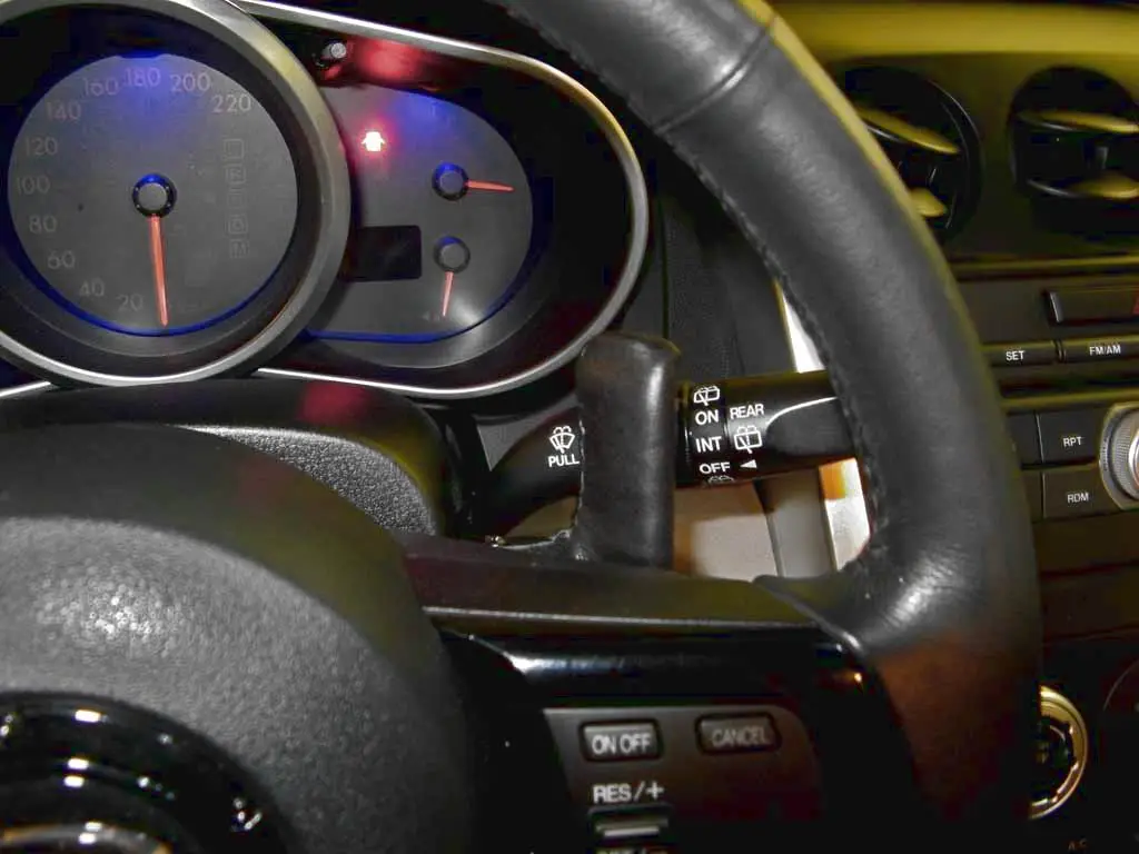

The lever should fall in easy reach of the fingers just above 9 and 3 oclock, and doesnt interfere with the turn signal & wiper levers
Of course, other mounting techniques may be possible.

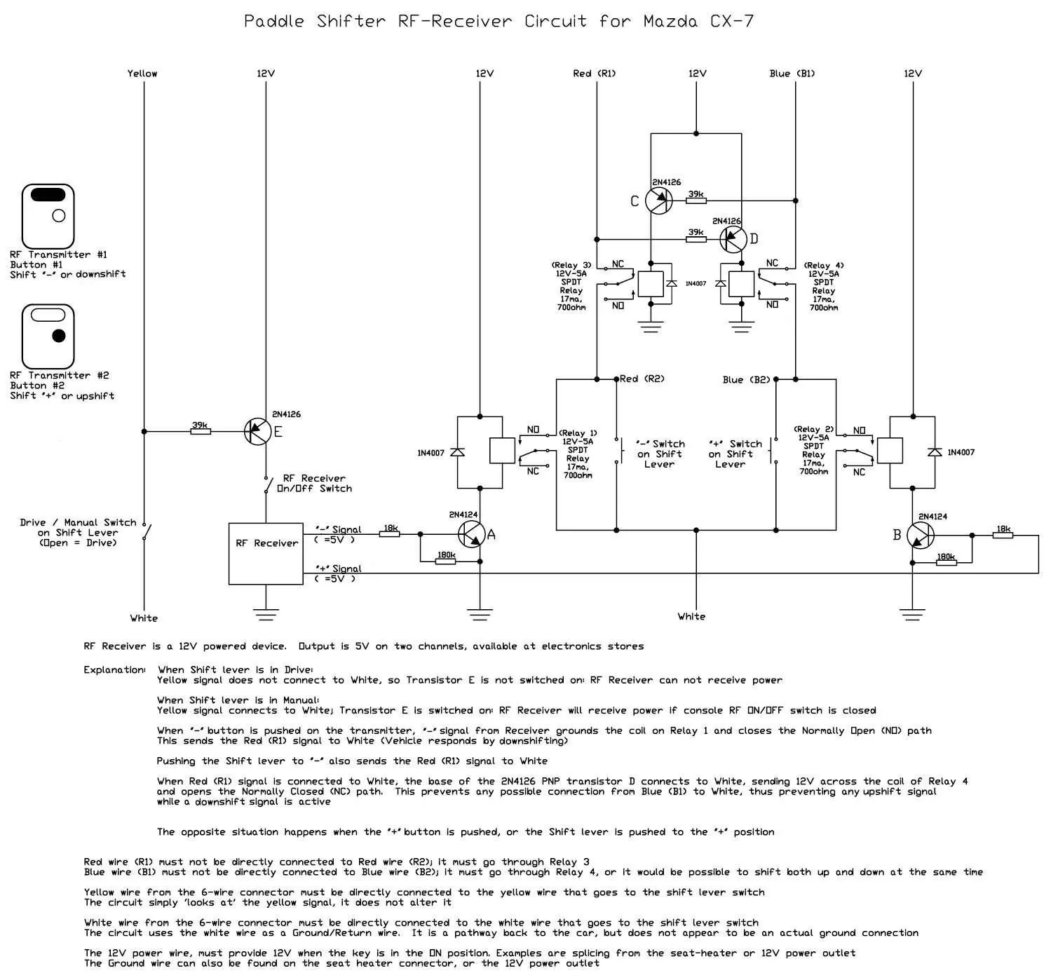

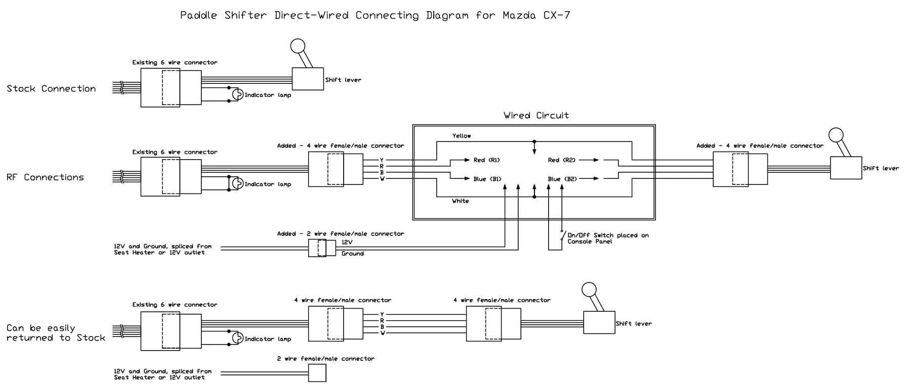

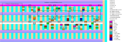

Electronic Circuit:
And now the circuit. If youre not handy with circuits, this project will be a bit of a non-starter. Perhaps you can get someone to build it for you..
The circuit allows you to use the upshift lever, and/or the upshift transmitter button at the same time. Or use the downshift lever, and/or the downshift transmitter button at the same time. It does not matter.
However, it prevents you from using the upshift lever and the downshift transmitter button simultaneously, or from using the downshift lever and the upshift transmitter button. (or both transmitter buttons at the same time)
How it does this, is by sensing when the shift lever is pushed, and blocking any signal to the other shift direction. (using the PNP transistors connected to the coils of Relay 3 and Relay 4). The PNP transistors will only allow current to flow when the Base is Low; so when the shift lever is pushed, the Base of the PNP transistor connects to White (Low) and this activates the coil of the relay of the other shift direction. When the coil activates, the relay closes (and the Normally Closed pathway becomes Open), thus preventing any possible signal from flowing in the other shift direction.
When the RF Receiver is inactive (or switched off), the car shifts as normal.
When the RF Receiver is active, and a transmitter button is pushed, the receiver sends a signal activating the NPN transistor (2N4124); and a relay (Relay 1, or Relay 2) closes to allow the car to think the shift lever has been pushed in the appropriate direction.
When the car is in Drive, (the Yellow wire is at 12V) the RF Receiver is always off, due to the PNP transistor which prevents current from flowing when its Base is High.
The Required Circuit Elements:
PNP transistor 2N4126 Qty=3
NPN transistor 2N4124 Qty=2
Resistor: 18k Qty=2, 180k Qty=2, 39k Qty=3
Relay 12V, 5A, SPDT, with 17ma / 700ohm coil (circuit board mount) Qty=4
Diode 1N4007 Qty=4
On/Off switch
4-wire female/male connectors Qty=2 pairs
2-wire female/male connectors Qty=2 pairs (ideally of different types see note in Overview section)
Circuit board
Mounting Box (there is a lot of room in the car, the box could be 6x4x8 or more)
Rubber Grommets to prevent wires from pulling out of the box

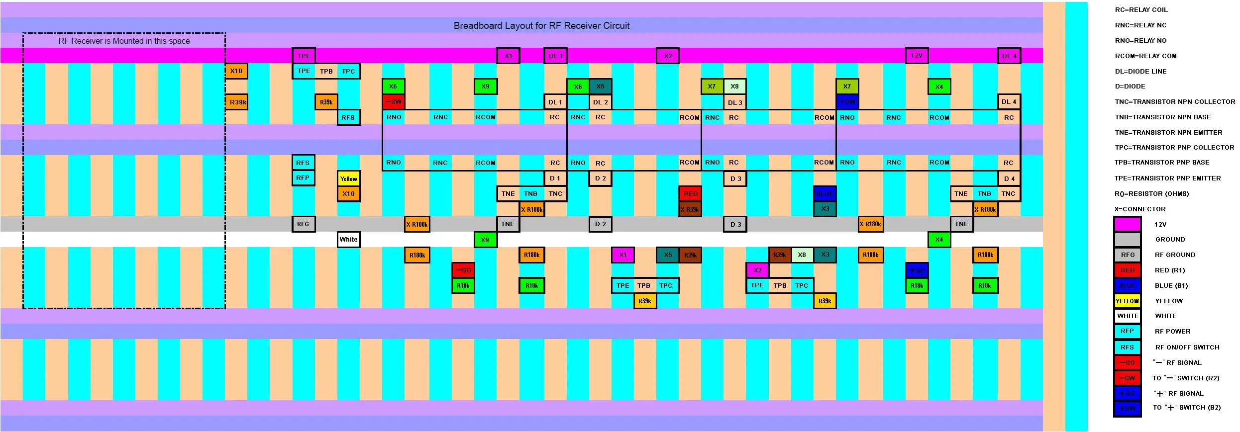

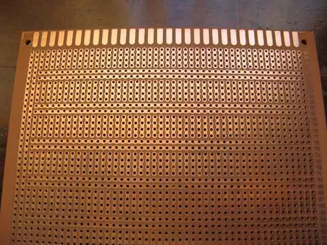

I used a pre-lined copper circuit board.
If you use a similar one, you may make sense of this diagram of my circuit layout. Note: that I used 2 relays of SPDT and two of DPDT because thats all the store had. So the outer relays have one unused side. SPDT is all that is needed.
The circuit is supposed to draw very little current, maybe at most 0.1A when the relays are activated and the receiver is receiving (since this is during shifting it should be very short in duration). None of the signals from the Red, Blue, or Yellow wires should be affected as they only go through relays, and the White wire is only drawing a very small current from the PNP transistors. All transistors are supposed to be either off, or saturated, so there should be very little heat produced through them. Almost all the power required is drawn by the 12V wires and outputs to Ground, which are fused through the seat heater or 12V Power fuse.
Note: if your RF receiver outputs different than 5V signals, you may need to adjust the 18k resistors to ensure the NPN transistor is fully saturated.

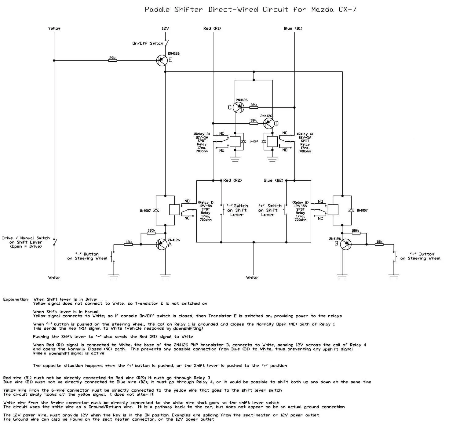

Wired-in Paddle Shifters for Mazda CX-7
This post describes how to add shifting from the steering wheel with direct wiring
The previous posts #1 to #5 described how to add wireless shifting with RF transmitters
Overview:

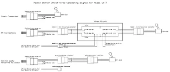

The Mazda CX-7 has a manual shift option using shift-by-wire, where the shift lever can be used to upshift or downshift to any allowable forward gear. I wished to add shift levers (or paddles) onto the steering wheel, while still retaining the use of the shift lever at the same time.
It should be possible to modify my circuit from the previous post, to use directly connected shift levers. I do not know how they would be routed through the steering wheel, but it should be possible. Also the shift levers could be mounted stationary on the steering column, avoiding the problem entirely.
However its done, route the 4 wires two for each side, through to the shift levers. (Really only one is needed for each side as the second can simply be grounded)
All the wiring connectors can be prepared the same way.
The modified circuit would allow the shift lever to be pushed to the - position, and the steering wheel - lever pushed at the same time, but it should prevent any crossing over of the signal.
Many of the cautions in my previous post would apply here too. Test your circuit well, before installing in the car. As I have not tested this particular circuit I cannot ensure its success, though it should function identically to the RF receiver circuit in theory. The parts list would be slightly different, and the circuit layout would be different also.
