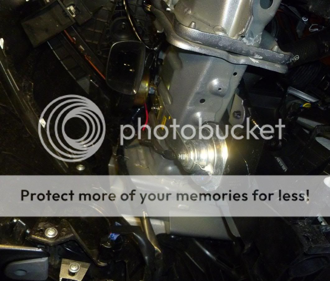

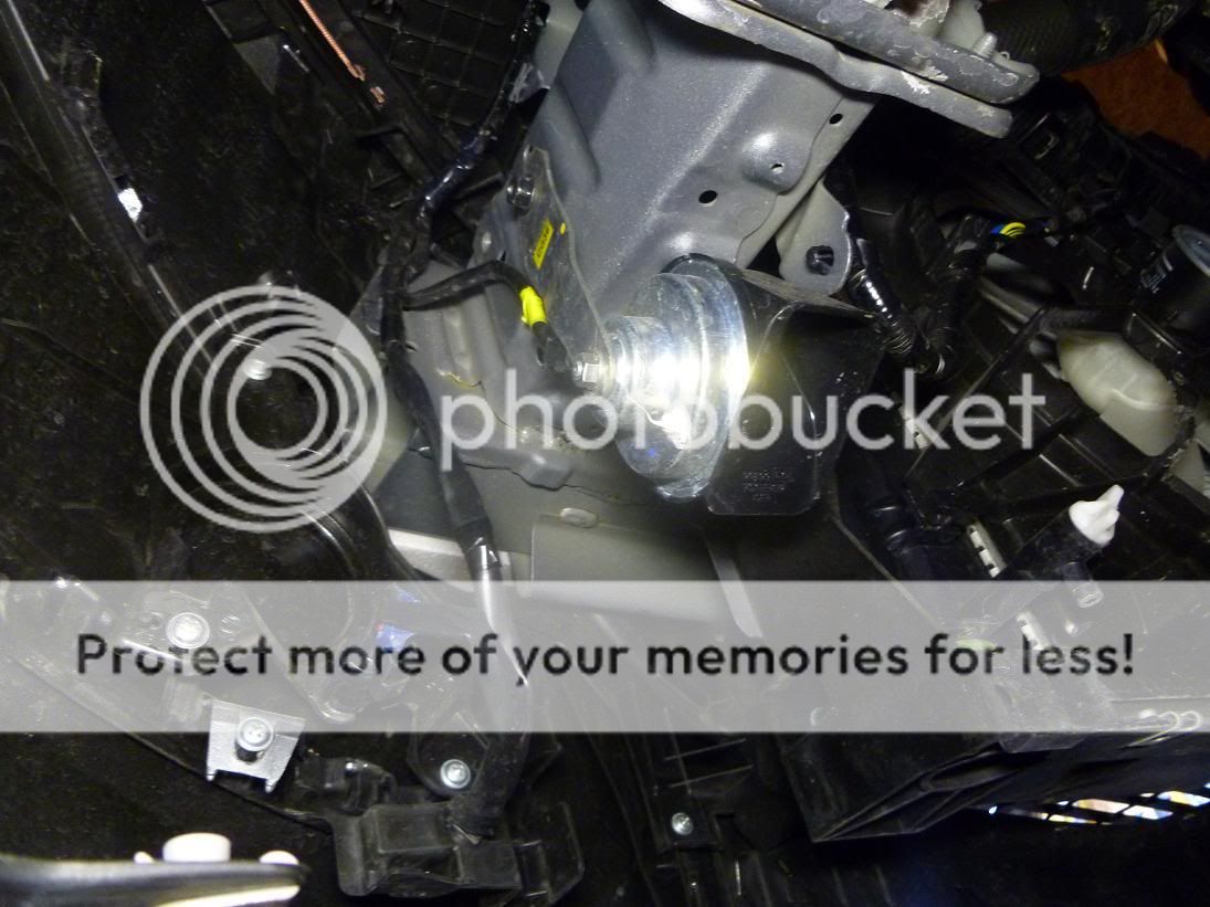

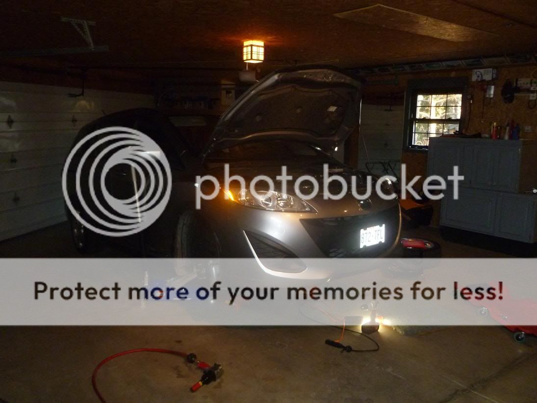

Anyway, I jacked up the front end, removed both front tires, removed the engine undertray via numerous 12mm bolts and annoying little plastic pop-clips (there's surely a removal tool that makes this a piece of cake, or you can use a flat blade screwdriver and pair of pliers, and a dozen or so choice curse words), and finally more plastic pop-rivets in driver's side front fender liner. No need to take this liner completely off, just enough clips to allow peeling it back back out of the way. Don't need to touch the passenger liner.
Enlarge one of the mounting holes in the bracket that came with the new horn with a 3/8ish drill bit and use the same chassis bolt as the OEM horn bracket to mount. After fiddling with the position settled on the new horn almost directly above the exisiting, with the horn facing down like the other.
Solder the power lead (you supply the wire and female connector) from the new horn into the OEM horn's single-wire lead after stripping off about 1.5" of protective wrap and ~1/4" of insulation from the wire, wrap in electrical tape and then heat-shrink and voila, at least double the hp (horn power).
With the fender liner and undertray there really isn't any kind of clear path for the sound waves to get outside at whatever jerk you're beeping at, but I can confirm that standing anywhere in front of the car when it's blaring will not be missed. Plus it imparts a nice buzz to the driver's feet :P
Took me about 1.5 hours start to finish which included drinking a beer and BSing with my father, who's in town visiting.
(breakn)
sorry for the dark pictures
Secured on jackstands:
Single horn:
double the fun:

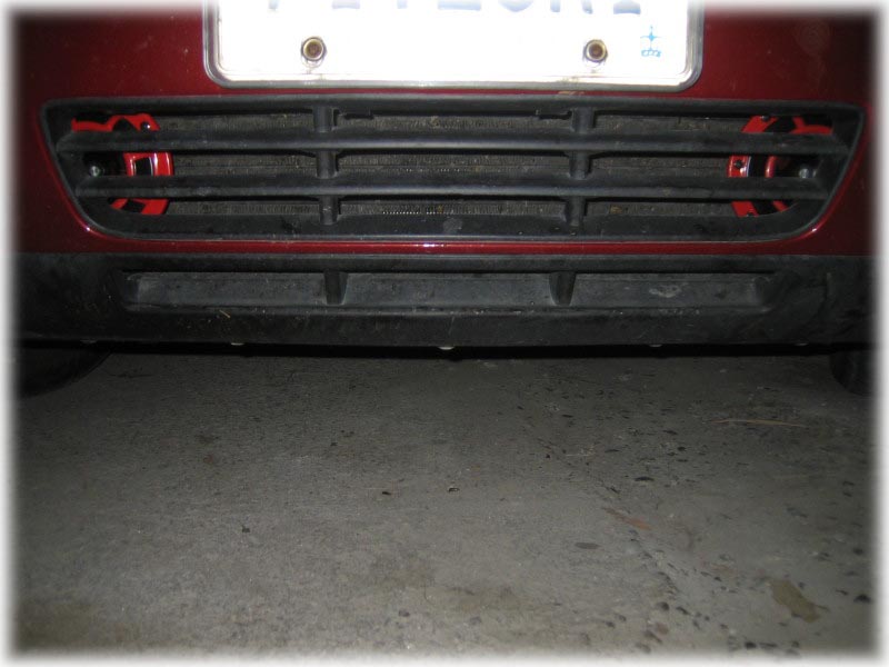

thanks Fitz - oooooh I've always coveted those Hellas. No issues with water hitting them?
The black plastic pieces around the M5's fog light area are easy to pop out, while under there I was thinking about cutting out some sections to let the sound out but wondered about water getting in.
I put this Wolo air horn in the Jeep that got replaced by the M5. Man that thing sounded GREAT, only thing was when locking the doors the signal was so short instead of a short "beep!" you got a short "pfffft!" from the air compressor :P
