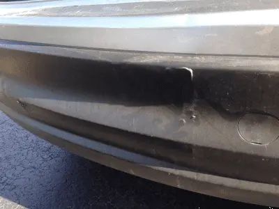

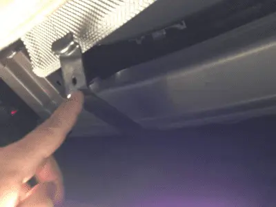

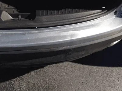

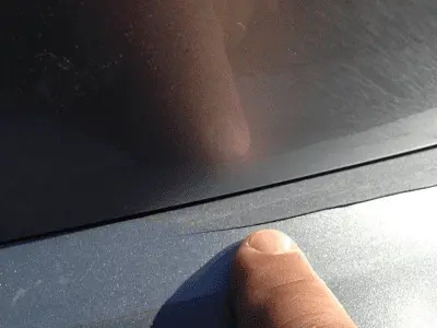

Well...my car went in for repair this morning. The collision shop said I should have it back by Thursday barring any new discoveries once the bumper is off. In the meantime, I was provided a Chrysler 200 rental...very few nice interior features and a completely soulless driving experience. Looking forward to the return of my CX-5.
Attached are some photos of the bumper from that the collision shop took for insurance purposes. The lip of the hatch was abraded, but it was too challenging to snap a pic. As previously noted, the collision shop will be spraying some clear to cover the lip/leading edge. I'll post photo some after shots as well.
