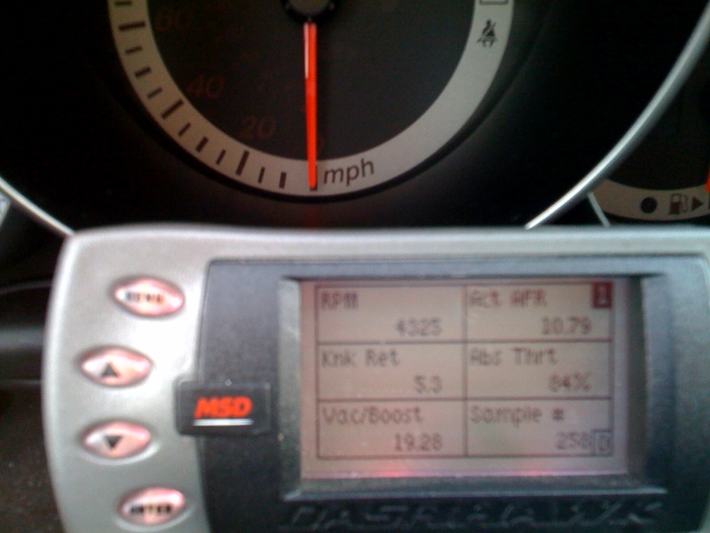

Yea I hear the dashhawk shows a lot more than the accessport and this who was sponsored by Cobb said he wouldn't get a dashhawk because you have to do more stuff to get the af ratio to show up.
No you can see the a/f ratio...
Only look at the top right one.. the rest are scary numbers..
Unless you are running and monitoring an actual wideband O2 sensor I would take any AFR reading with a huge grain of salt. You can reference it if you'd like but I would not use that as a value to tune against.
