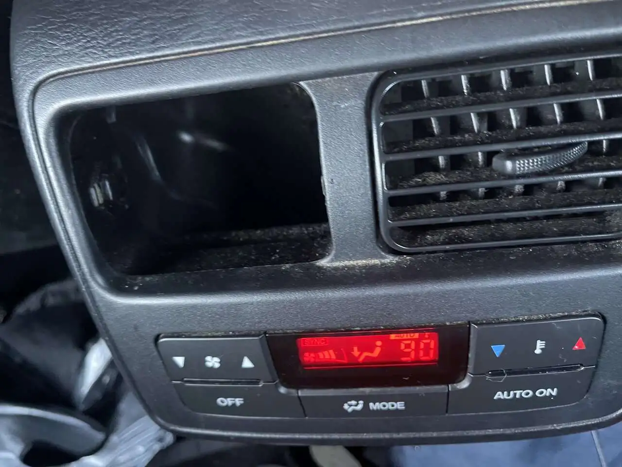

hoping to gain insight to this same issue..the rear vent has fallen into the console, clueless on how to retrieve it.
any help is appreciated!!
I have a slight problem with my Cx-9. My kids kicked the vent covers into the rear ventilation system that runs through/under the middle console (I love kids!)? They are so far in there that I can't see or touch them. Does any one know how I can remove the center console and access the rear ventilation system to get them out?

My son kicked in the vent on my rear console. Can you send me instructions to take it apart. Also how do I reorder a replacement? Can I just order the fan grill?
I have the same problem. Can someone please assist, thanks.
