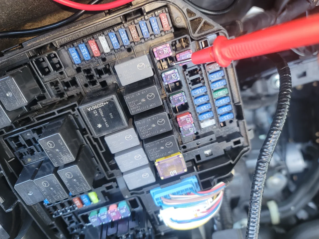

The F43 (30A) cooling fan fuse was blown.
I replaced it, but it blew again as soon as I turned on the A/C.

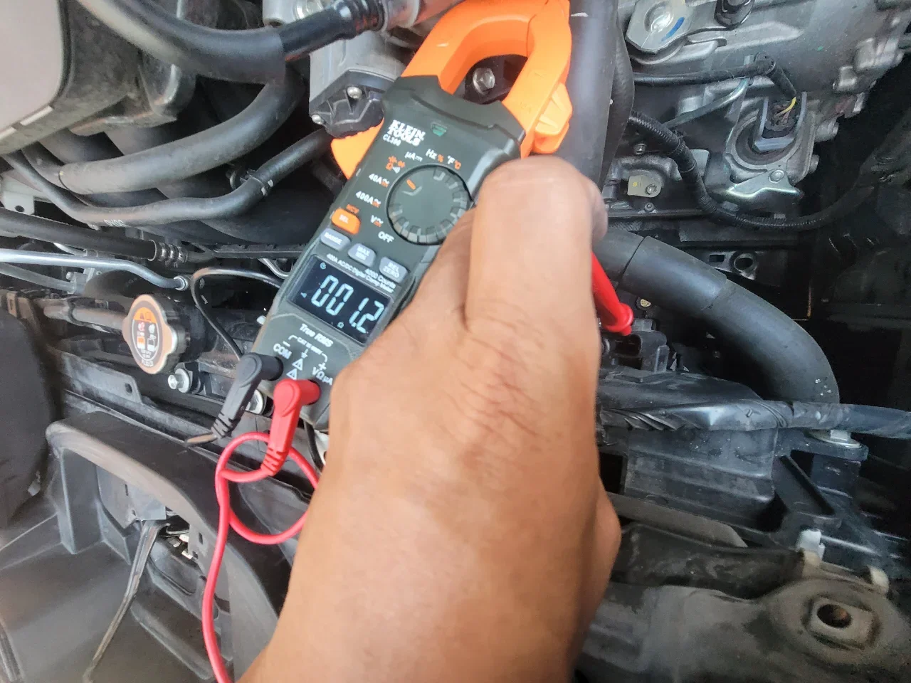

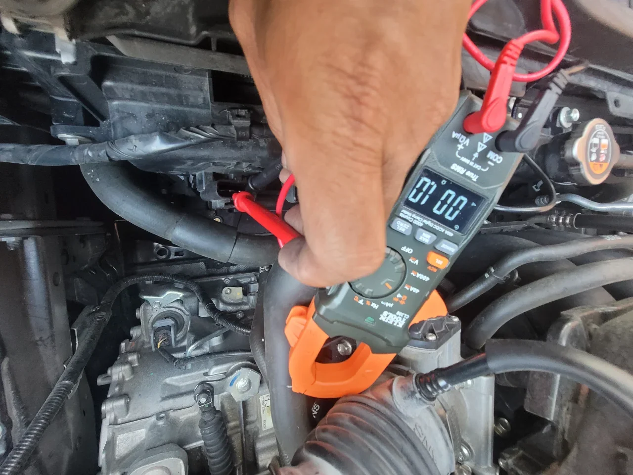

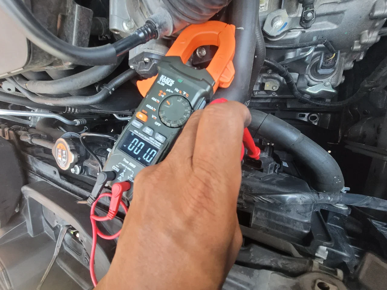

After some online research, I did a bit of troubleshooting:

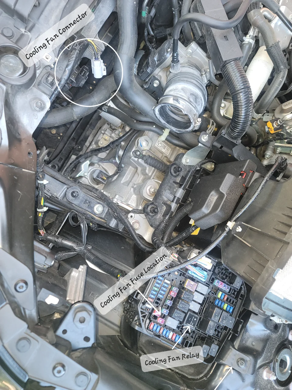

Removed the airbox and disconnected the cooling fan power.
Replaced the fuse and started the car — it held.
Turned on the A/C — the fuse still held.
This points to the cooling fan or relay being the culprit.
I tested the fan connector and found continuity between all three legs, which I believe is normal. No open circuit.

This is where the fuse is located. The larger square relay is the bosch type relay for the cooling fan.
These are the 3 legs of the power to the cooling fan.

Appreciate your sharing the troubleshooting process. You said you tested the relay and it was good, did you mean you swapped it with a different one and it worked for that other function? The relay you marked seems to be of a difference size/spec from all the other ones in the box. Asking so I can learn. Thank you!
I used a meter and removed the relay then used a 9volt battery to 85/86. Made sure I can hear the click on/off. Then also confirmed voltage on 30/87. I also tested where the relay goes and tested continuity to where the fuse goes.
Thank you!
Does the fan motor turn freely? I'm not sure if relays blow fuses, but a bad motor definitely could blow a fuse.
Just a quick update... dealership still has no clue. So far they're trying to imply that it maybe due to my remote start that's using a tharness to the ECU. Good thing I'm on a loaner so don't have to worry about "rental" cost.
IMO it might be the motor to the fan.... with all that salt air and sand I get weekly, I'm sure it's affecting the windings.
