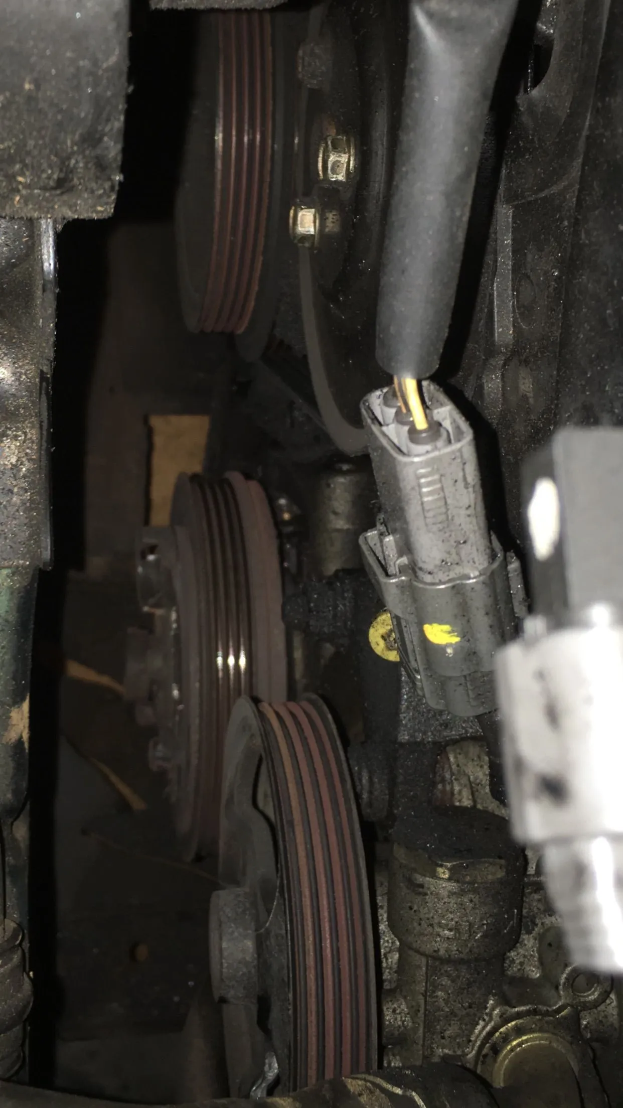

Does anyone know if my car has enough clearance in order to put on a shorter belt and by pass the AC compressor completely without having to remove it?
Compressor locked up and I just want to get through the next 5 months without AC so I can save for a new Car.
I have a 2000 Mazda Protege' DX 1.6 Automatic Transmission. Thanks in advance.
Take some sort of straight edge and line it up across the top of the pulleys and see if it clears.
That'll give you a good idea if you've got clearance.

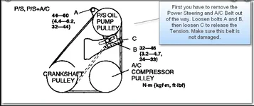

IMG_3760.webpGood idea but I think it's bottom of the pulleys that I need to do this to. The top will definitely clear.
But this is a different diagram to a different car. I have a DX with a 1.6
Or is it the same on all of them? Sorry, I just don't know. ;-)
Yea I just found this. I think it will clear. Now all I need is to find someone to do it. The guys around here don't bother with that.
As I have a bad back and also don't know what I'm doing with cars. I found someone to do it for me. There is only one other issue. When the belt snapped, part of the belt melted on another pulley that that is to the left of the Serpentine Belt.
Don't know what that Pulley and Belt are (Alternator?) for but that belt is in tact. But again there is melted Belt on the Lower Pulley of the Alternator. I tried to scrape the melted belt off the pulley but it does not seem to come off. Maybe part of the melted belt is stuck somewhere else. I don't know.
Guy is coming on Wed., I will have him look at it.

Update: There is not enough clearance on my model Protege' to just put a shorter Power Steering belt on.
You must take the clutch, pulley and the Coil completely off to get clearance. Much bigger job.
I finally had it done and belt is on and running fine.
