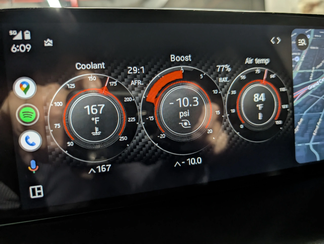

After fiddling with it, I have 4 PIDs working.
Afr is at the bottom between trans and intake.
I'll work on chqnging the units to SAE.
Its supper easy to start after connecting to Car Play, simply scroll to the app and poof it's working.
Here is my first cut at one of 3 screen options.

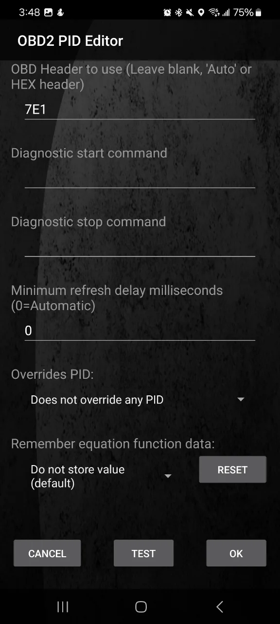

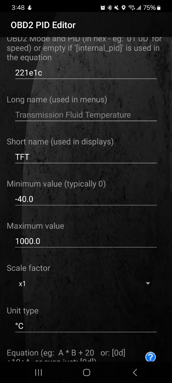

The transmission PID may be incorrect, the default one in Torque reads coolant temp as trans temp. I screenshot the custom PID that will get you the accurate temp if you want it.
