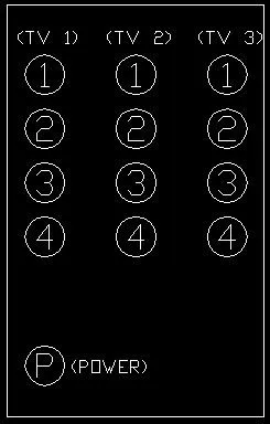

I went and took a close look at the av/controller i just ordered...here is what the remote looks like..well a drawing of it...
(see pic)
also it has 4 power connections, 1 for power to the a/v controller and one for each tv..I can turn the tv's on or off with the remote..i like it..i have a toggle switch that does that now..but i will like this setup much better.

its ir...there is an ir sensor that plugs into the controller that i can stash somewhere where the remote control can see it..but its all wireless baby..yea!
Well if the remote is Ir when you go to change one visor or head rest if the other display works off the same IR codes then both will switch.
no because the remote control will control the source on the a/v controller, not the tv's...so the first row of buttons will control output 1 on the a/v controller, the second row, output 2 and so on...the remote control doesnt actually have any thing to do with the tv's..just the a/v controller
