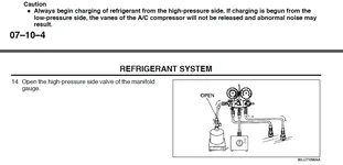

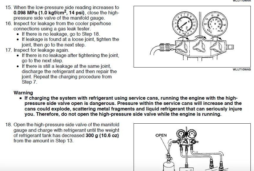

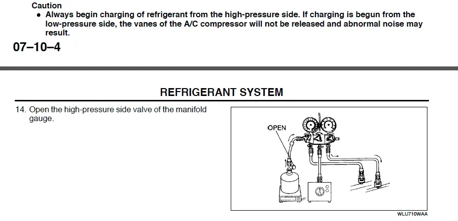

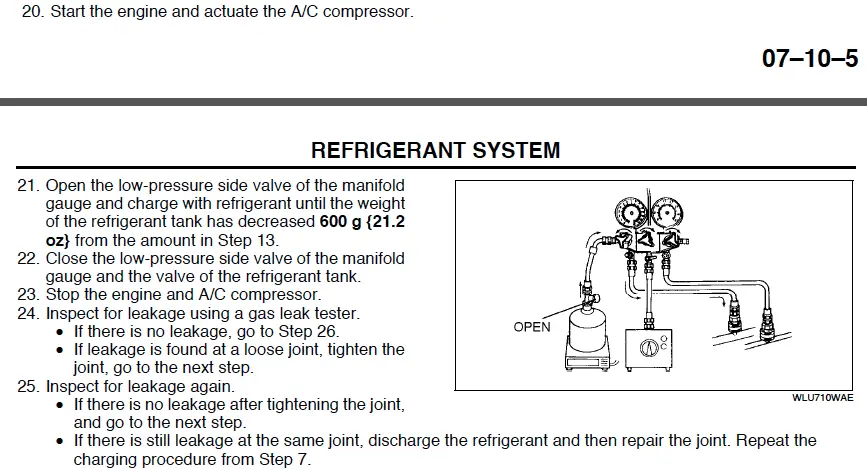

I thought it was strange too, but that's straight from the service manual. Here are a few snapshots.
And I'm definitely getting flow from the can since I can get some to go into the high side. But when I open the low side valve the pressure just hangs out at ~70 psi, which is definitely high for the Low side.

The system could be clogged or a line bent to prevent freon from going in the system. Is the system at 70psi no matter if the car is on or off?
I would bet that there is a problem with your low side service port. You aren't getting flow from your gauges to the low side of the system. The 70psi is pressure from the can.
I had that problem once too, forgot to tighten the low side connector so it didn't push in the Schrader valve. Doh!
You can charge through either side initially. However once the pressure in the system equals the pressure in the can, no more freon will enter. At this point you need the compressor to engage and draw the low side pressure down lower than the can, so freon will enter the system again and you can continue charging.
With the compressor running, you should never attempt to charge through the high side, the can may burst.
You may have a stuck expansion valve as well. This would be my first thought. Either that or a restriction somewhere, but since your AC compressor didn't implode on itself this isn't too likely. Many times when an AC compressor eats itself up it will send trash all throughout the lines and you have to flush them or guaranteed to get crap stuck somewhere it doesn't belong and cause AC issues.
How long was the system left open to the atmosphere? did you change the dryer? Any time you open the system it is wise to replace the dryer, the desiccant sucks up any moisture pretty much immediately.
I'd still put my money on the expansion valve. I'll replace one every time i touch an evaporator whether it needs one or not. They're cheap and many times just exposing them to the atmosphere seems to cause them to not operate correctly, especially on a car that's 15 years old.
The expansion valve seems to be the culprit here, there's just no flow from the low side. The Low gauge never moves, it just hangs at the pressure of the can, around 70 psi as mentioned.
The compressor clicks on and the High side rises slowly to around 110 psi, and that's where it stops.
Should I pick up a used evaporator from a junkyard? Do I have to go with a new one? Or should I just replace the expansion valve?
You'd think if the valve was stuck there would be very high high side pressure. Did you make sure the low side service port is clear and working?
You don't need to replace the evaporator. In my case the fittings were a real pain to get apart, but I replaced the evaporator without replacing the expansion valve.
Wouldn't you have to short the thing that prevents compressor from running when low on refrigerant so that it'll run and suck in the new stuff? Had to on my old Toyota truck. Haven't messed with it on the P5..........
Yes, that's what mechanics do, rather than trying to fill it up on the high side with the A/C off (as the manual says)
The only time the high side is used is with an A/C refrigerant machine, with the A/C off
I've never had to do that. Charged dozens, with and without a vacuum.
Also depends on the low side switch cutoff, but normally it only takes 20 or 30 psi to trip it.
The ports are clear and gas is able to flow, I've verified that multiple times.
And I don't think I need to short the compressor because I followed the manual by charging half way through the high pressure port with the engine off. This was enough to trigger the compressor to come on.
My problem seems to be that the low side pressure simply doesn't change. It hangs at whatever pressure the refrigerant canister is at. The high will bump up to around 110 psi max after the compressor runs a bit, but after cooling off the high side equalizes with the low side.
Anyone have any insight into what's going on here?
Edwin, I see you're still around here after all these years. I seem to remember you knowing everything about these cars.
What's broken? Where did I go wrong?
If that is truly the case, you either have a stuck expansion valve, or the compressor is spanked. The latter would be unlikely considering that it worked fine before you took it apart.
Replace the expansion valve. This is exactly why i replace it every time i open the system whether it needs it or not :) Save the time of doing the job twice!
