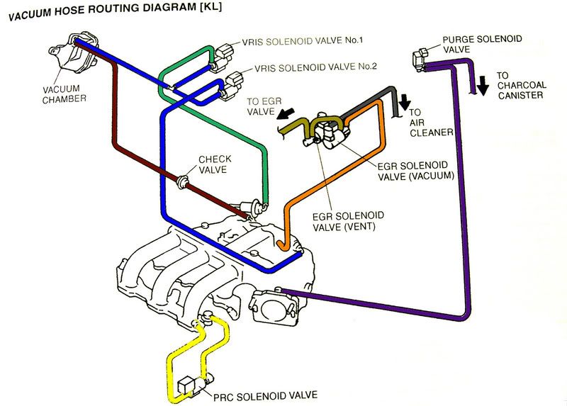

Not exactly, the only vac lines in the 2.5 that connect to the EGR come from the EGR solenoid vent I believe. I have the diagram somewhere.
As I mentioned, but I will clarify- check the vacuum supply to the boost sensor from the intake manifold. If I remember correctly- the boost sensor and egr solenoid share the same vacuum supply. The solenoid is turned on providing vacuum to the valve and opening it up. Pretty sure the valve has an electronic lift sensor on it as well. If the port at the intake is plugged- the all 3 components will not get the necessary vacuum supply and the system will not work as designed.
Here is the Vac diagram for the 2.5L KL-DE.
